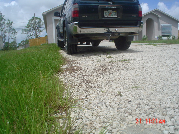

for the dual exshaust its looks good sounds good and adds extra horse power but its if you do a dual exshust its gunna have to be a custom set up since they do not make a direct bolt on kit for the 4runner
dual exhaust wont add horsepower... its coming back from the cat.. so it has more air to flow and less pressure which results in power loss. same idea if you get bigger diameter piping..
if you want the look go for it.. however its not gonna help.. it might even decrease your power.
