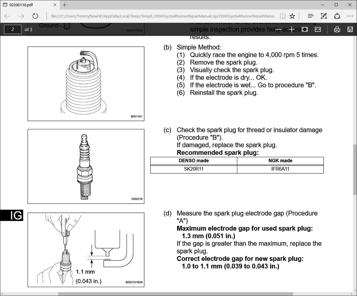

Spark plugs for '08 v8
Spark plugs used to be pretty simple but not these days. I have been searching for the "right " plugs but there are so many numbers I'm getting a head ache :(
The 4th gen is a few years old now, mine @ 123K miles and my mileage indicator says 16.0<>16.2 mpg. Are the plug numbers in manual valid anymore? I want to chg plugs and this may be the only set of plugs I ever put in this motor :) which plug is gonna last longest? laser? iridium? krypton? plutonium? platinum?
thanks for any opinions :)
