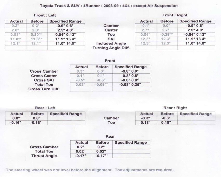

I would say to check the obvious. Jack the front of the 4runner up, spin the driver and passenger side tires by hand to see it there is any resistance difference between the two sides (maybe a dragging caliper or wheel bearing). Can you post a print-out of the latest alignment. Being told "its fine" doesn't cut it for me- I need numbers (did alignments for 8 years at my former job). You said it had a bent rim, where, right front? If so, I'm thinking the hub may be bent a little. Did the shop replace the strut on the right front?
I don't have any actual printouts of the alignment specs ... never asked for them but next will for sure. Although I do remember even looking at the machine on the Big-O system where one number stood out from the rest, no idea what I was looking at, just saw one # on the computer screen off ... I asked about it and the tech said 'well, that's still within spec, that wouldn't cause any probs, I've seen a ton of these like that no problem yada yada'

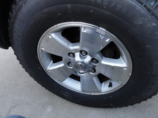

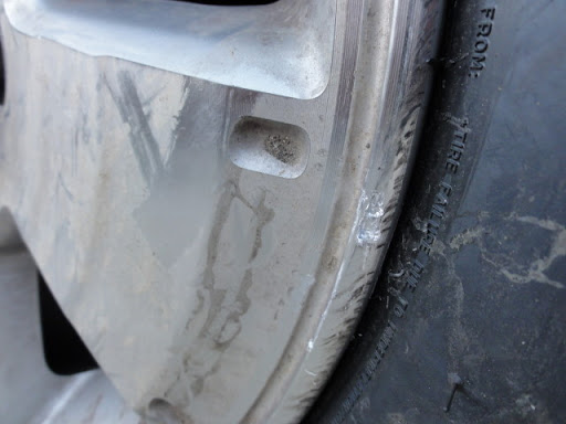

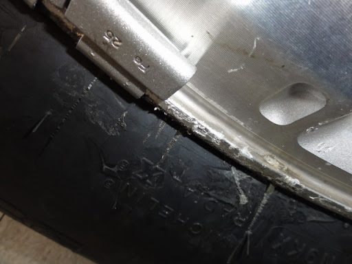

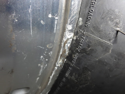

BTW it gets worse, I'm kinda liking these Michelins for the ride (less the obvious vibration problem), but closer look at the rims now shows Costco may have jacked me - 3 out of 4 rims have nasty scratches/gouges after I insisted they rebalance the tires via lug-centric adapter instead of the cone dealio they were using UGH UGH UGH!! I'll start another thread for that...

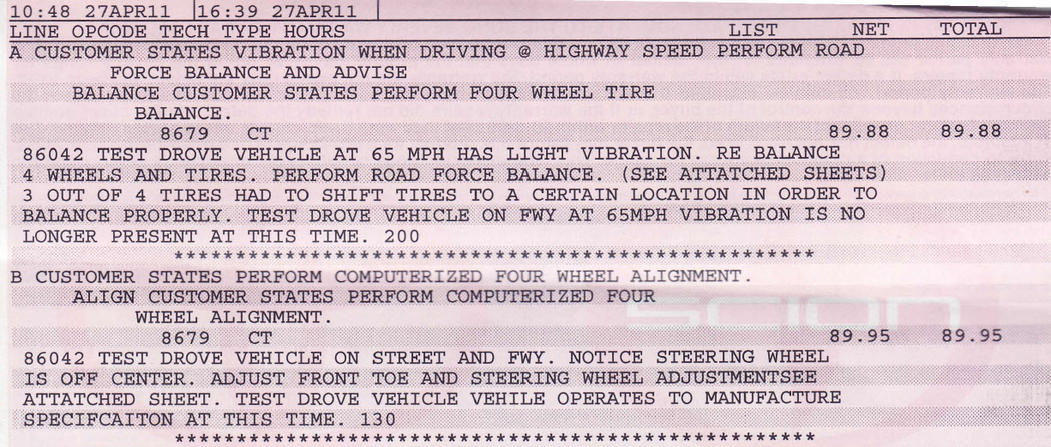

Update: back to dealer yesterday. Service Manager took the time to listen to the entire story and felt my pain. Promised to check everything thoroughly, but insisted they gotta start with a rebalance and realignment (the dealer was the only place that didn't take a crack at the alignment yet)
Realigned, toe was way out of whack. Steering wheel off is now fixed.
Then they road-force balanced on the Hunter 9700 ... brand new tires were completely out of balance, wrong weights used (e.g. multiple smaller weights used on some of the wheels where they should've probably used one heavier weight, etc... so the weight distribution would've never been right), at least that's what the dealer said.
NO bent rim as Costco claimed, that one balanced out fine on the 9700. I attached the alignment specs & service writeup.
Low and behold, super smooth at all speeds now, and the pull is gone. :trophy: My baby is back to life! :D

3) Inspect your rims carefully - here's the number the Costco guys did on mine... so I've got some complaining to do there now :ybrick:...
AT LEAST... I have my vehicle back and it drives right now, so aside from the rim mess I guess I'm finally a happy camper.
Went from this:
To this......
