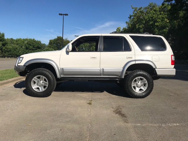

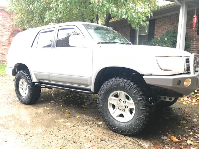

Had these installed today and so for so good. Upgraded from Goodyear duratrac 265/75-16’s. These TG’s are less noisy but do seem to drift a bit at 70mph.
I have a toytec 3” lift only and slightly rub at full lock. It’s raining today so I have yet to investigate were it rubs but I will update soon. They are clearing the uca’s by about 1/2” sitting on the ground. Plan to stuff and drop the wheels soon to see if there is any rubbing there.
before and after pics.

Dang the 33's look so much better filling up the rear wheel well. I have some 265/75/16 wildpeaks that have 4K miles on them and will be putting a 3" rear lift next month. I have a real long time till I will have bigger tires like that, but something to look forward to. Also, the paint matched bumpers look killer! I have one in the same color and i'm trying to decide on matching paint or going black.

Thanks man. I have been through all sizes of tires and finally stepped up to the 285. Wish I would have done it as soon as I got the lift.
If I got to do the bumper again, I would have rhino lined them that color and not done paint. Off road they have gotten pretty scratched up. If she was a mall crawler though, paint would be good enough.

Well I think I am going to have more rubbing issues then i thought. At full lock right I rub the right side frame and left side UCA. Full lock left clears. At full drop I’m also into the uca’s
Now off roading is going to be even worse I believe. I need to figure out a way to stuff these front wheels and turn to check for clearance. From the looks if it I may rub the rear of both wheel wells.
What do you all think to remedy? Start with uca’s? I’d hate to spend that much on those and it yield no more clearance.
