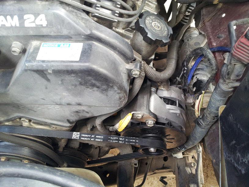

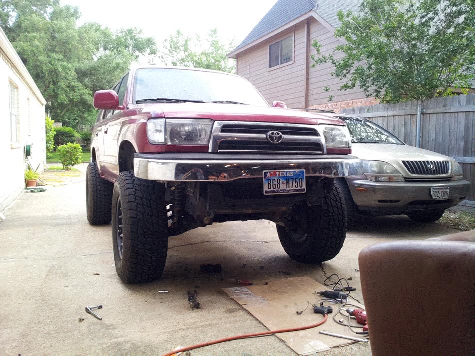

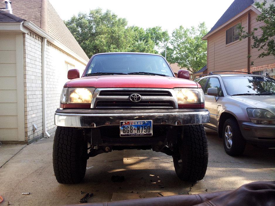

First off sorry there are not anymore pictures. For some reason I end up getting stupid dirty and dont want to break stride when I start on a project. My 4runner has the CS 144 install, and that as well I didnt even take pictures. On the install I recently got all new belts so I had plenty of room for adjustment on the stock belt and did not need to use the 2" shorter one I bought.... I want to build a prerunner bumper and keep the look of my 4runner looking nice so I am thinking of welding a prerunner and skid bumper like baja style from the frame horns, wrapping around the existing upper chrome part of bumper and no hoop. I have access to a fab shop and a really good friend who went to fab school so he is going to guide me and give me a hand. Today I ripped off the bottom valence and moved my tinted turn signals behind my grill...turned out to look really good IMO. Let me know what you guys think about it! I also have a 1" BL so I installed a 4Crawler/RB bumper gap eliminator....Tomorrw ripping off the sr5 black stripe trim down the side. As well as installing the stock OEM look tail light LEDs. Tomorrow I will snap some shots and add them once I finish...here she blows:

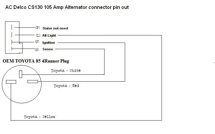

Also I might add here is the wiring diagram that I used for my pigtail for the cs144...I had to dig around on forums for a bit to find it for some reason thought it would be easier to look up. My pigtail 3 wire was all black wires and were lettered by each wire. Pretty simple..

not bad, but I'd be a bit nervous driving around with out any protection to the condenser and radiator, post up some shots when you get the rest installed, good job on that Alternator
yeah I still am a little sketched about it...but that front piece that went across the frame horns under the plastic was not much protection anyways...it wont be like this for long just wanted to get some ideas

On the street it looks a little ghetto without something below the bumper and I like the tube bumper idea to replace the plastic valence but off road it's no big deal.

Haha...Yeah did some more work today...The CS144 install went great and easy and im super happy about it and without the valence I could see straight through to the lower bolts made it super easier dropped right in...another trick was to reach through the side around your upper left side of the UCA to get at the one positive bat bolt on the back bc things get tight with those swaps and I didnt think to do it before hand.
