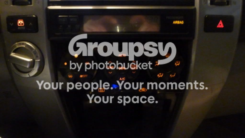

I've read through all the posts I could find relating to swapping out the bulbs for LEDs and replacing the stock bulbs in the center console, however I still haven't been able to figure out what's going on with mine.
Specifically, I pulled my trip computer out and removed the two bulbs which are housed behind the screen. To the naked eye neither of them appears damaged and every other bulb in that cluster works (fan controls, vent controls, defrost, recirculation, airbag, mode and reset). Here's a picture of what mine looks like (sorrry about the poor quality; I had to leave the flash off to show the lights):
P1010410.jpg~original
Any idea what could be causing just the screen not to light up?
Thanks for posting. Same problem started for me a few days ago. I'm interested to seeing the responses. A search gave me a post but hope for more info. From the post, since I have to take part of the dash off I'll replace all the bulbs that I can get too. Do you have a link for a post on how to remove the center console to change those lights?
The bulbs are probably burnt out, even though they look fine to the naked eye. Try replacing them, they're cheap. I just did mine this past weekend.
In the pic above, it also looks like your bulb for the "Reset" and "Mode" buttons is burnt out too.

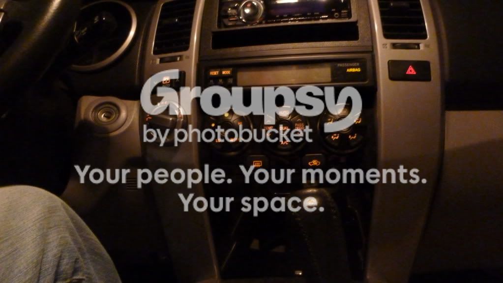

Very odd, because when I first took these pictures today those lights were out, however after I put everything back together this is what I saw:
025.jpg~original
Maybe the contacts were bad or something...
I'd second just changing out the bulbs ... I didn't actually check my old bulbs to see if they looked like they were burned out, but putting new bulbs in did the trick. Nice to be able to see my display again ...

Yeah, I ordered two new bulbs last week and they arrived over the weekend while I was out of town. I just finished putting them in and the trip computer screen is fully illuminated again.
