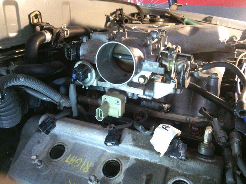

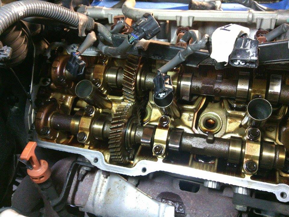

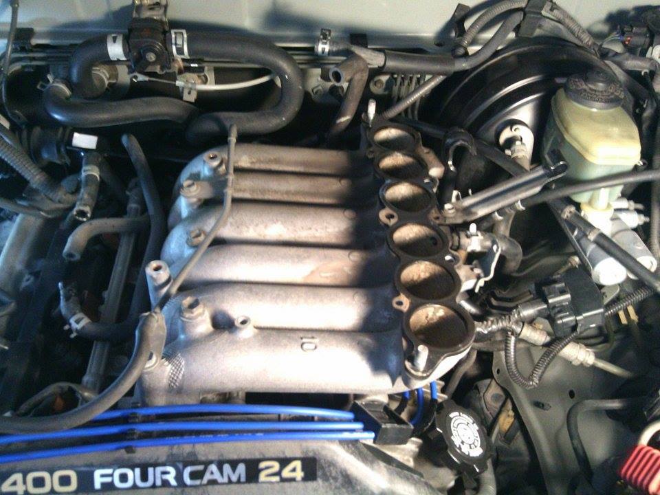

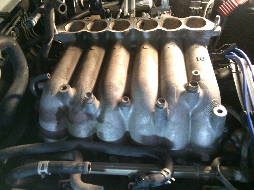

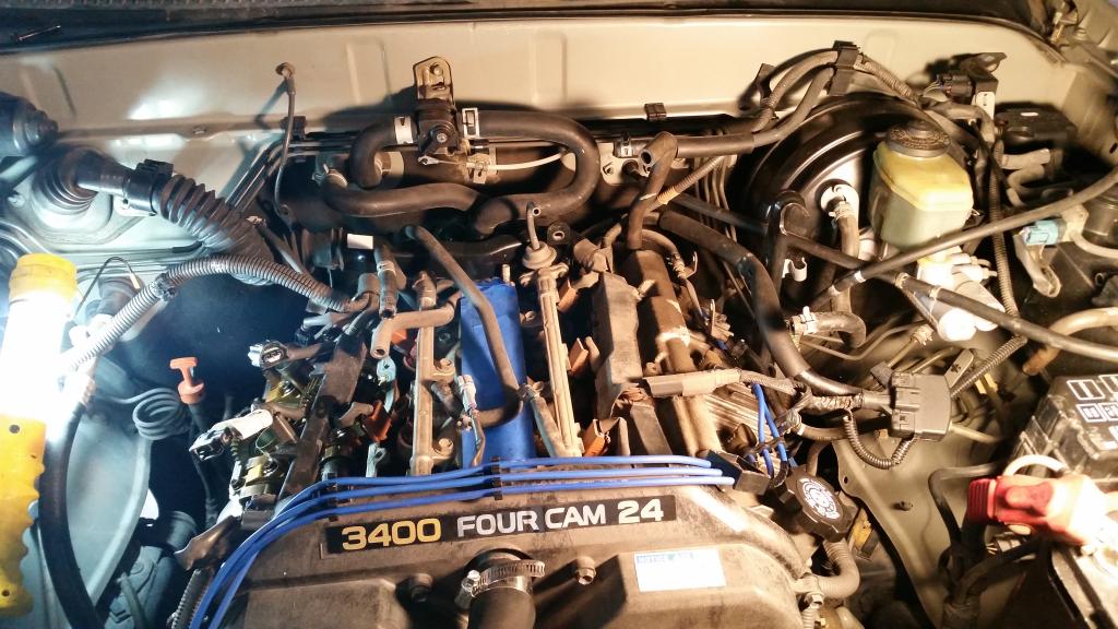

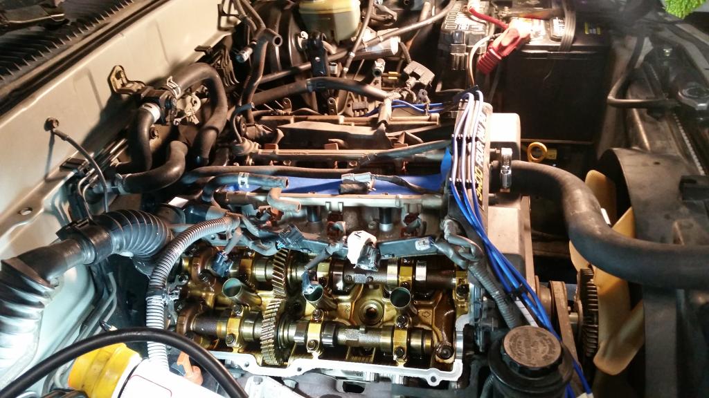

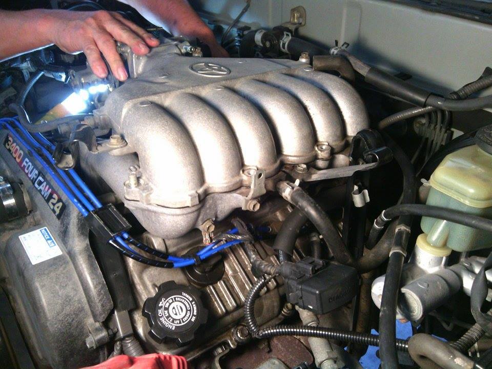

Finally had time to work on my runner this past Friday. Had my dad help me on this job. Took us about 8 hrs. and a few beers. Found out it was my half moons and camshaft plugs that were leaking oil. Now since I fix the oil leak, will it be safe to switch from Mobil Super HM 10w-40 to Mobil HM full synthetic 10w-30? I ran 10w-40 because of the leak and that it gets crazy hot here in Brownsville, TX. Here are a couple of pics.

You can, but if your cams and such look that clean, why switch. At this point just enjoy your ride after your repair.
Mobil Super HM is a great oil for a darn cheap price IMHO. Run it for 5000 miles and enjoy.
