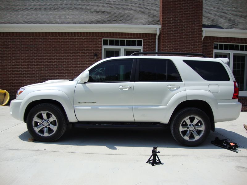

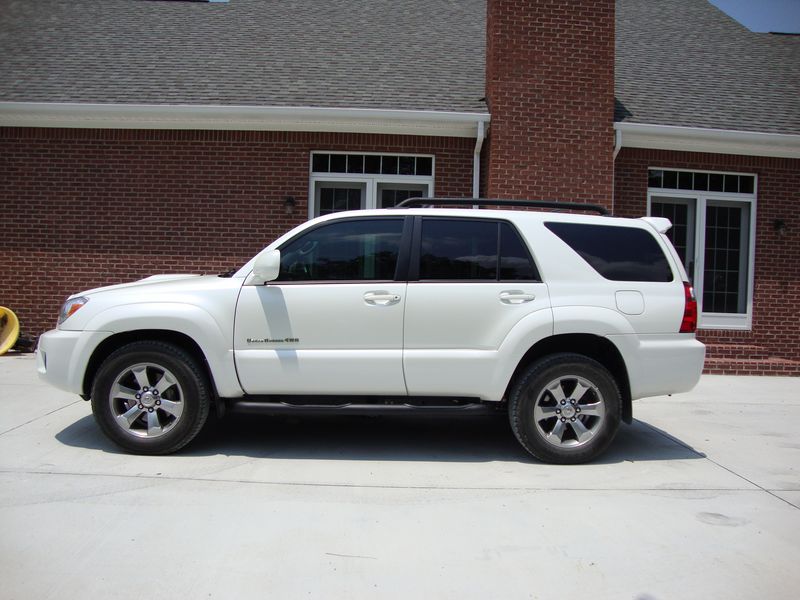

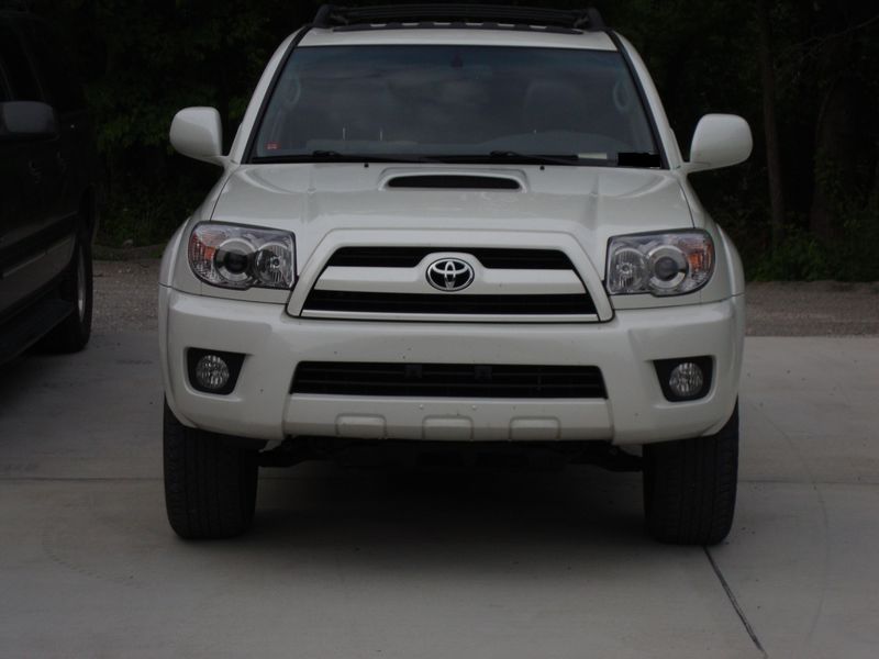

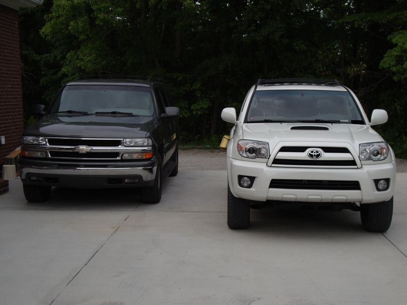

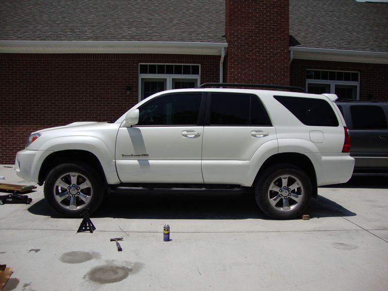

My FJ springs and Toytec 1/2" spacer came in last week, so I couldn't think of a better thing to do then put em on the 4Runner this weekend. Overall, love the look, love the ride. Many thanks go out to J.A., Arkswamprider for their write-ups and everyone else who swapped their OEM springs for FJ springs. In all, I spent 7-8 hours with the install with a helper. (that would have been about an hour shorter had I not dropped a strut tower nut that lodged itself between the rotor and hub...what are the odds?) First photo (before), second photo (Rear FJ Springs installed), third photo (finished product FJ Springs and 1/2" front Toytec Spacer), fourth photo (finished product) and fifth photo (finished product next to Chevy Suburban 4X4)

Yeah, the ride is much much better...stiffer springs do not always equal better ride, but in this case they do. There is much less body roll too, so it seems handling has improved as well. Do you have the same experience?
What was your total gain in height?
I didn't take any measurements before/after, but my best estimate would be 1.5"-2" in the front and 0.5"-1.0" in the rear. These photos probably give everyone a better idea of the extent of the lift.

Did you use the FJ springs in the rear also? FJ springs in the rear also? Did you reuse your stock shocks?

Yes, FJ springs front and rear. I left the factory XREAS system alone, so yeah, it still has the factory shocks.
Looks good! I think everyone who has done the FJ setup has reached the consensus that it provides a better ride.

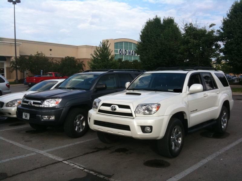

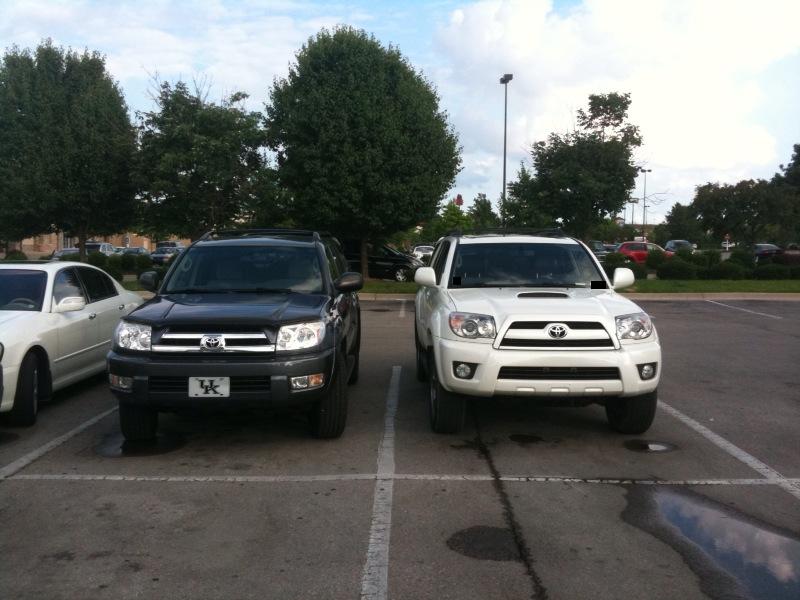

Front fender to top of tire - 6", Rear fender to top of tire - 6.5". Factory rubber on factory 18" wheels.
Hmm, guess my setup is different due to the rear air. I've got about the same difference front/rear, but I have stock rear (OEM rear air suspension). That difference is perfect for these rigs, looks awesome!
