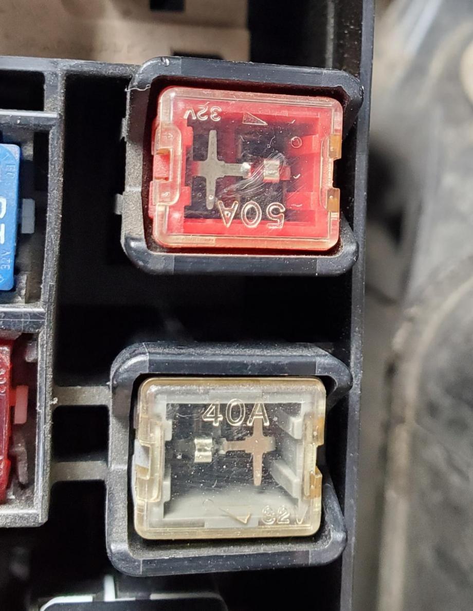

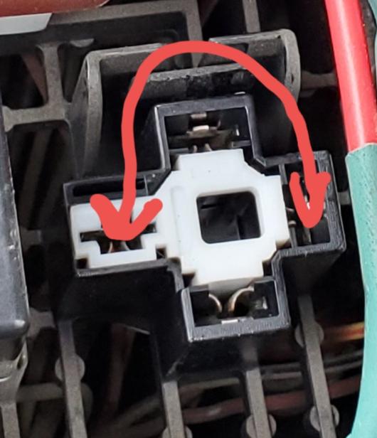

Saturday I swap starter relays with my other truck and still nothing, all the blade type fuses check OK with a meter, not sure how to check the bolted in ones like the alternator fuse but they look OK. The relay from this truck works in the other truck so it's not that. I end up running a jumper wire in the starter relay spot from the 3 to the 5 wire pins(red line in photo) and it starts right up so I drove it home the went back on my bike to get my Subaru I left there. Searched the forum for a while and only came up with the park/neutral safety switch. Not sure how to test this and I'm not super handy with electrical stuff. I'm not exactly sure how to test the # 1 & 2 don't think that's the issue. I think the problem is between the key and the relay. There is no aftermarket alarm system, it has the RS3000 but I have never had a remote and never have used it. I did see a couple drops of water on the drivers floor mat below the inside fuse panel, I cleaned the sunroof drains in summer and all was good. Where should I be looking for the short ?

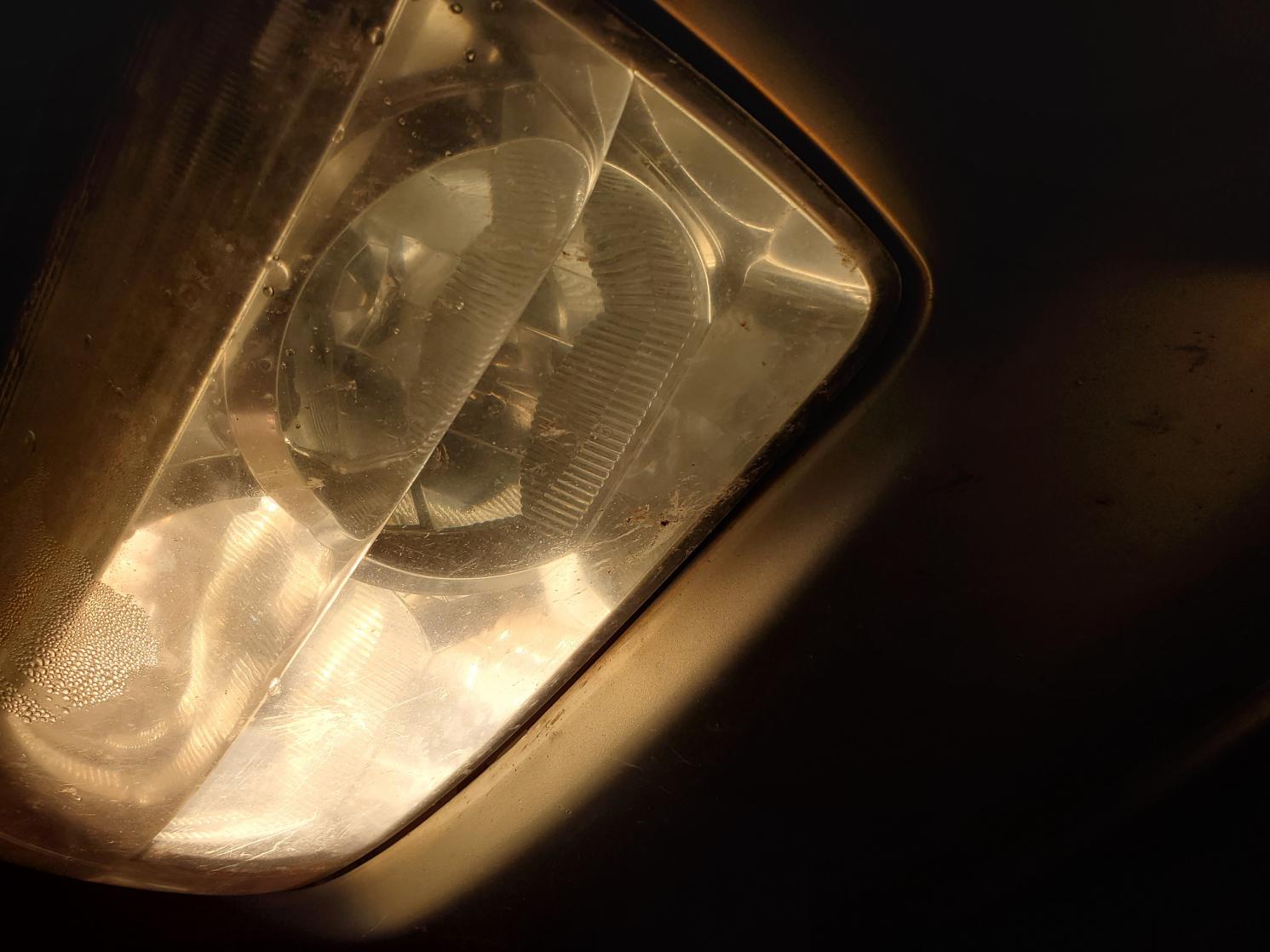

On a side note when driving the Subaru back at night the passengers headlight was pointing at the ground so I figured somebody backed in to me again... nope, I have a fishbowl going on. I've had this car 6 years and not a drop of moisture in the headlights then suddenly it's full. WTH ?

Also dry out the headlamp and connector. Never see a headlight just give up its sealant so quickly before.

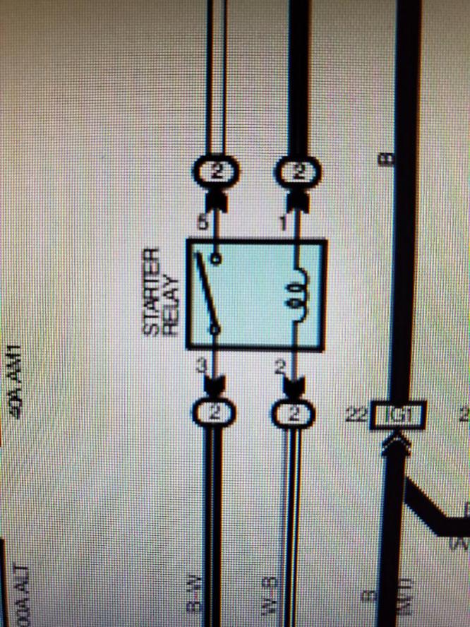

I can start the car easily by jumping the #3 to #5 at the relay so it's not the starter and the relay works in another 4runner, I'm getting slightly less that battery voltage from the #1 pin at the relay and it's not enough to kick over the relay. That's as far as I got as it's raining here...
Was going to take a look at the park/neutral switch before I started tearing other stuff open. Any suggestions are welcome as I'm not an electronics whiz

If it starts by jumping 3 to 5 and that relay is good. Then starter etc has been ruled out as fine.
Pin1 goes to the key [ ignition switch]
Pin 2 runs through all the safety switches
No mention of it being a standard just 1998 sr5 v6.
So this eliminates the clutch switch and the clutch cancel start.
The RS3000 is going to complicate things.
So what happens if you simply unplug it.
Does this change anything ?? As that unit is tied to the a pile of circuits.
Form what I am seeing its 1 of 3 things..
1] RS3000
2] ignition switch contacts
3] the park neutral position switch
