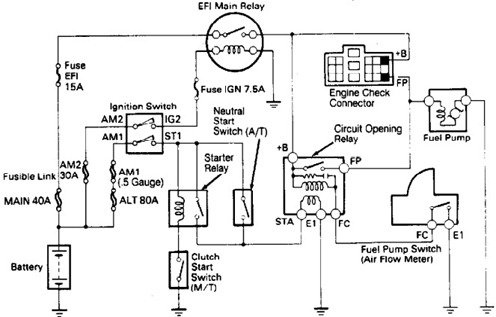

relay checks
there are a bunch of relay's in the starting sequence. in my own no start i had to add a bypass relay to the fuel pump.
:worthless

OKay, so when the pump ran, could you get it to start and run?
If not, its probably not relays, but if it did run, then I'd check the relays shown in Willy's post.
I know that when I turn my key to the start position (actual cranking position, not ON position), if I don't have the clutch engaged, I can hear the fuel pump pumping, that would confirm if the relays were working, but only if you have a manual trans.
Just trying to figure out if you have an issue with fuel flowing TO the injectors, or fuel flowing OUT of the injectors. Its obvious that the vehicle runs with starter fluid, so it has to be fuel flow at this point, just need to determine the above before moving forward.
