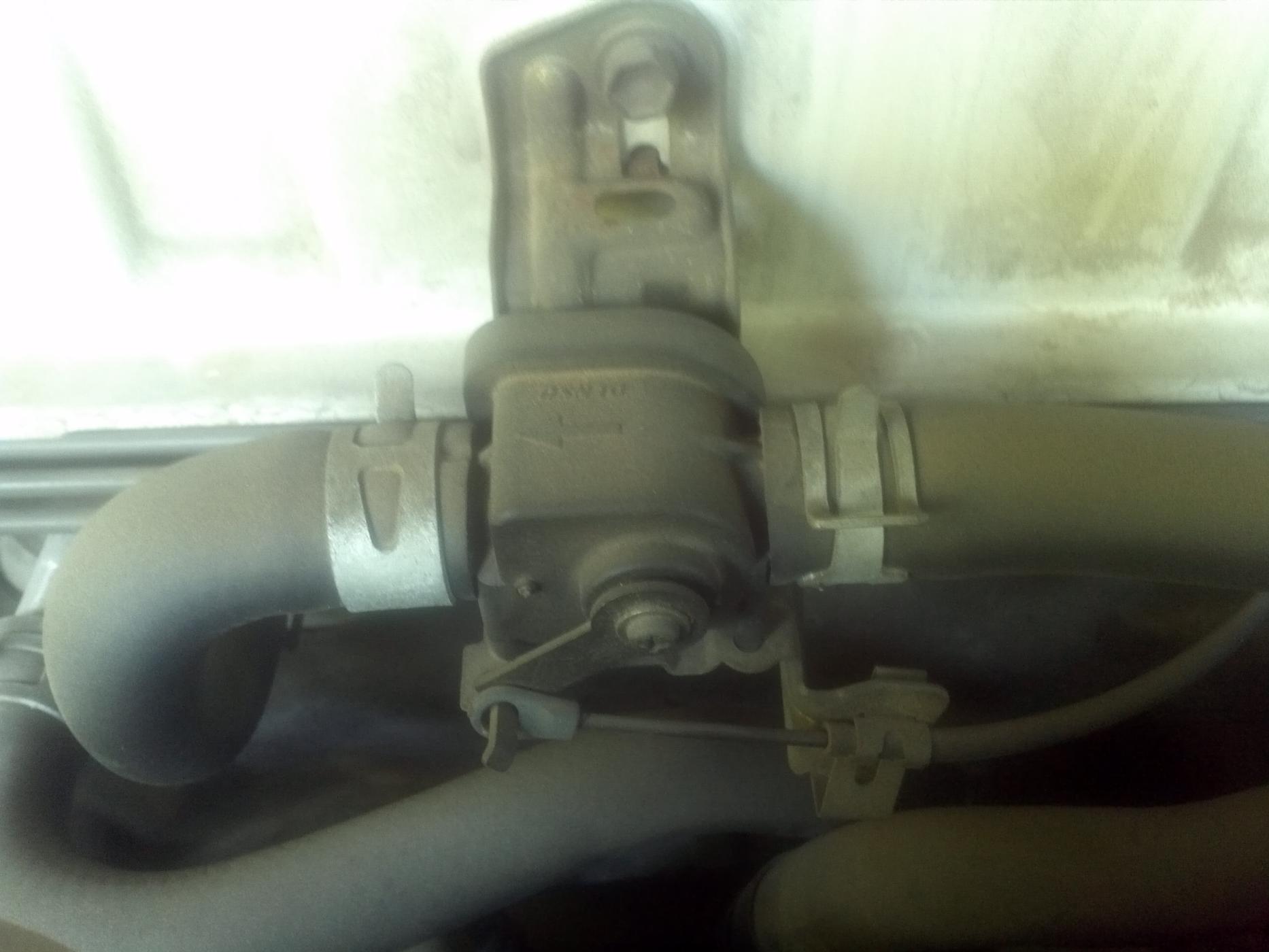

There is a cable that open and close the heater valve allowing hot water to flow in to the heater core. This is located in the firewal right behind the engine. It looks like a black plastic unit with 3/4 inch houses running into it in either side and on top of it there is a leaver attached to a cable. See whether this leaver moves as you select the heater from inside of the truck. Feel the hotness in the water before the valve and after the valve when the engine is running.
I have posted a thread on how to remove the heater core called "heater core removal". There you can find on how to remove the glove box in early part of the thread.
This is the valve.

Yes thanks alot. I will take out the blower motor and clean it out. hopefully that is all it is. if it is the heater valve how expensive is it to replace that? and could i do it myslef?
Thanks for posting the pic!
Heater valve is plastic. The only way it can go bad is to leak coolant towards the heater core, which is what you want. What I am thinking is, may be the leaver is loose and it won't open the valve.
Have you checked the rear heater? Is it works fine?
Yea thanks for the help on the heater valve. I checked it this morning and it moved when I turned it from cold to hot so I don't think it's that. I will check the blower motor next. Thanks for the help and the picture on the valve. Any advice getting the blower motor out?
