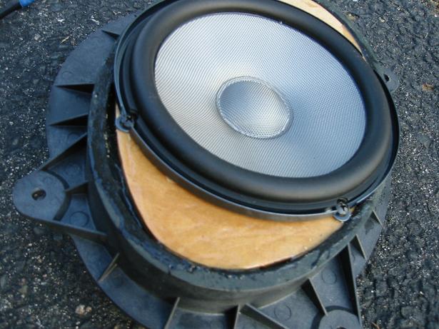

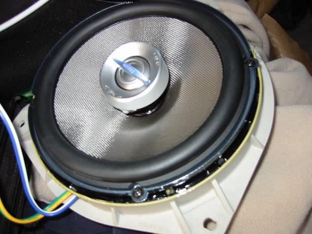

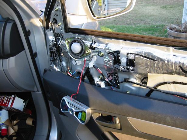

OK, the speakers are all in and they sound great. Turned out the 5x7 coaxials did not fit in the rear doors, so I got 5.5's and used the stock plastic to mount them. Had to cut away some plastic on the door panel to make it fit. In the front, I cut adapters out of MDF for the woofers and the tweeters.
I might see about getting an amp at some point. The Scion HU is nice, but it doesn't seem to have the oomph to take full advantage of the speakers. I sometimes have it turned up to near max volume when listening to MP3's. It's not booming loud, but I don't like booming loud.
