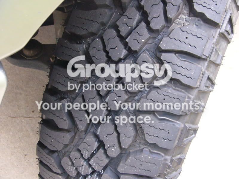

You should look at the Goodyear Duratracs.
P1050193.jpg~original
The 265/70/17s will fit stock as long as you don't have or want wheel spacers, however I found the tires to be uncomfortably close to the upper control arms without them. I ended up using the wheelspacers with a spacer/fj coil lift and still needed to move the fender liners forward and trim the mudflaps. No issues with the rear. Love the tires though and they have been awesome in the snow.
