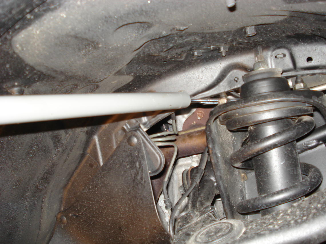

Are you saying you loosened the center nut that compresses the coil spring to get the spring and shock out and the top mount plate with the 3 studs is stuck inside the mount? I just did mine last week, 2008 but it came right out. I guess it has to be rusted together in there. Try spraying some rust buster penetrating oil in there and maybe a piece of 2x4 to hammer against the 3 studs downwards. Hopefully it will pop right out. There was a rubber isolator at the top to keep metal/metal contact apart? See picture. Keep us posted. Once you get everything apart, be sure to take the time to deal with the rust. Rust coonvertor and paint with truck bed liner before reassembling.
