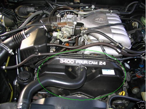

Where can I find the sticker that has the note when the timing belt was replaced? The owner cant remember when it was replaced. Thanks.
I've heard that most shops will write the mileage onto the upper engine cover (the black plastic cover with 3400 on it). If you can't find any markings and there is no documentation of it being changed, I would assume it hasn't been. If you know the previous owner used a particular dealership then you can have that dealership check to see if the service was performed.
The sticker will be easily visible somewhere on this piece of black plastic.
