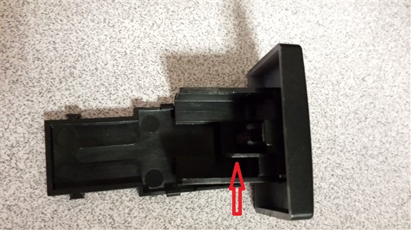

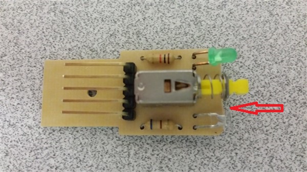

Sounds like face plate isn't depressing internal switch far enough down to engage/disengage, got a little experience here :eyebrows:
Had two Slee switches that did the same thing, fix is to "message" face plate. Notice tabs on back side of face plate (sorry for crappy pictures), while engaging and releasing switch you will see where they contact with switch housing, shaving they down 1/16" will allow switch to be depressed a little further for a better latch/unlatching.
and/or shave front edge of board only where face plate tabs come in contact. A razor knife makes quick work of it.
Great solution and worth trying if one has this problem!
You could also shave the backside of the faceplate on the cover as well....could be bottoming out when switch assembly is installed in the dash.
