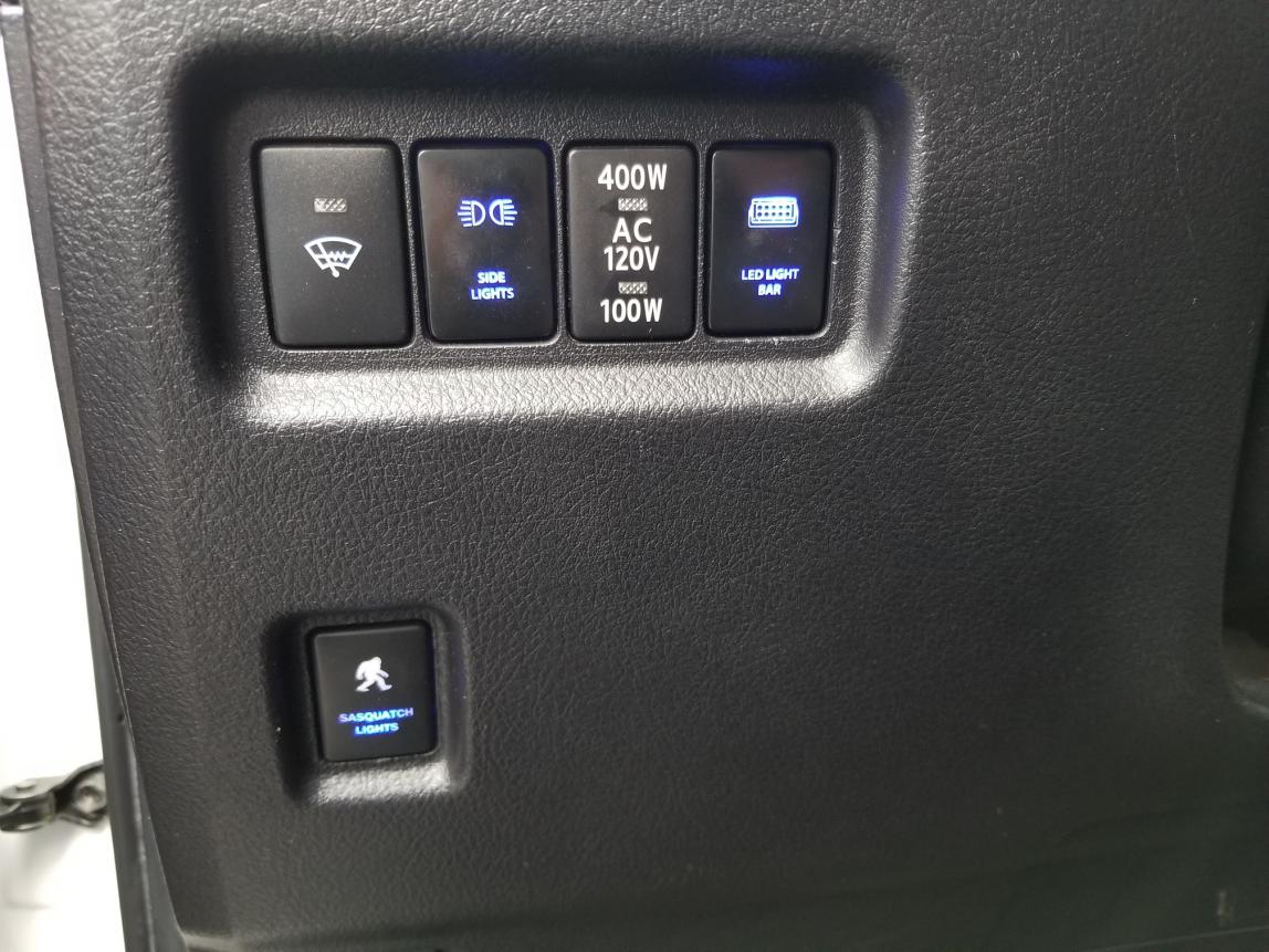

ONE complaint is the LED in the "sasquatch" light that illuminates when activated, no longer lights up (which is kind of a burn, because it controlls my rear amber led light pod & not knowing if that is on can suck).
But yea, good switches imo

I have 3 switches by CH4X4 & all 3 work just fine. Just saying...
I bought the sasquatch light as well (because I live in the Pacific NW!) and the image NEVER lite up for me as new. And AOB didn't care. I kept trying to problem solve (knowing it was defective) They didn't care. I hate AOB because of their responses.
