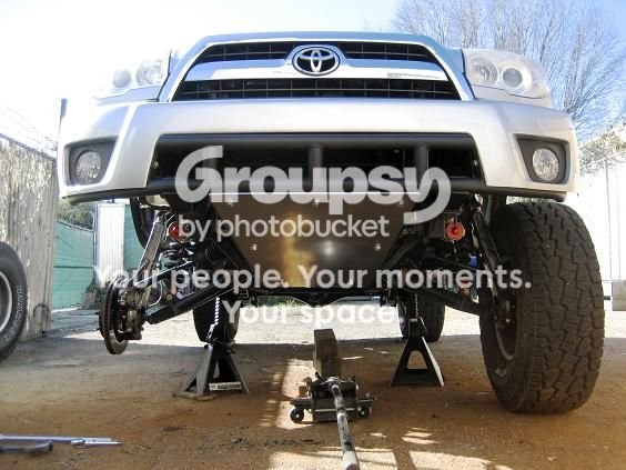

BTW Ryan - jealous of that bumper... Modeling mine in CAD before I start to fab one up. I wanna get an idea of angles and what not. How far does that bottom horizontal bar go towards the outside of the front bumper cover?

It extends out just past the fog light
P.S. Not my 4runner

Ryan - thanks for the pic. I really like that idea. I'm thinking about having the top horizontal bar coming out to the front of the bumper possibly to hold a few lights.
I'm guessing it fastens to the skid plate mounts on the bottom and to the front of the frame rails.

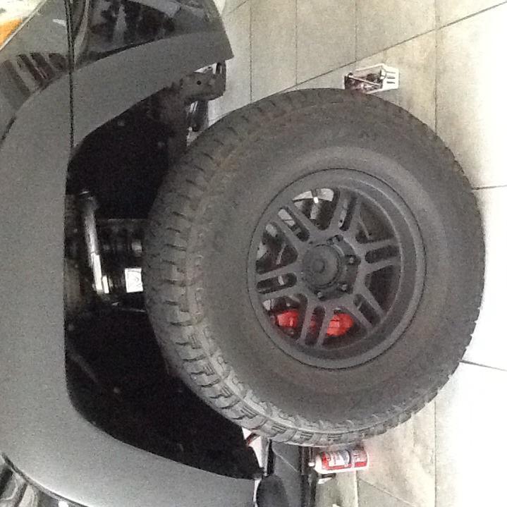

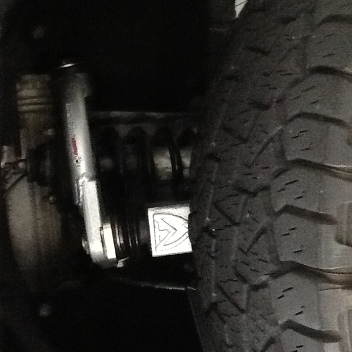

here is mine , i just degreased the maching oil and primed and painted . i used a caliper paint only because its silver and didnt want it to yellow.

Looks good. I'll have to look into that caliper paint. Seems like it would be a little bit more durable than regular rust-oleum.

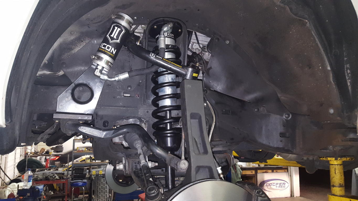

Here's a pic with the spindles and a set of extended length Icon 2.5 remote reservoirs on it (set to Icon preset height).

I didn't exactly follow the directions (because there weren't any) when I was routing the brake lines but they work fine at full lock.
