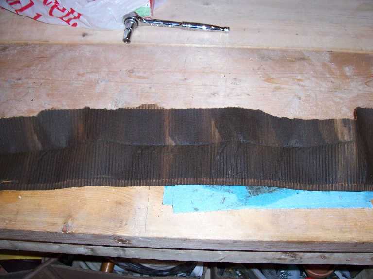

I just finished replacing the fuel filter on my 2002 4Runner. The throttle response noticeably improved with the new filter. When I took the old filter off the truck, the gas that came out of it was sort of dark, so I decided the cut the old "Lifetime" filter (as Toyota calls it) open to see what the filter media looked like.
The old filter had 100,000km (62000 miles) on it, and let's just say there was nothing "lifetime" looking about the filter media. 95% of the media was black, and I got black semi-greasy stuff all over my hands when I took the old filter apart and un-rolled the media to take pictures. I attached the picture below for those of you that might believe Toyota when they tell you that there is no need to change your fuel filter.

Thats about what the one in my taco looked like after 175k. They do need to be changed about every 30k.

In the tacoma the mpg's went back up to normal, and that was about it. The fuel is now flowing more freely less junk in the filte to slow it down, so I guess it's easier on the pump.

I just changed mine last night.
Talk about an improvement in power delivery.
Oh, and the sludge that came out the back end was just incredible. 113k mi and a lot of bad tanks of gas took it's toll on this "lifetime" still-stock filter. I'll definately put this one on my list to change more frequently considering it's ease (easy location).
