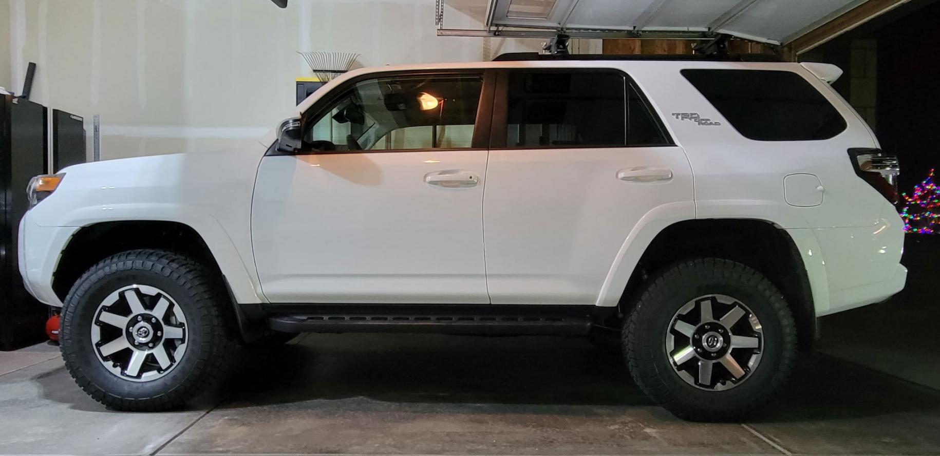

Yesterday, I did bilstein 5100 on all 4 corners along with 2 new bilstein 1in larger coils which gave me 1 in in the back. The two 5100 on the front I set at 1.75. Glad I did it my truck thrives better, it’s more spotty and you sit up higher. I paid 208 for new springs and 400 total for my 5100’s . the install guys at tandem off-road were great. Got my alignment dead on.

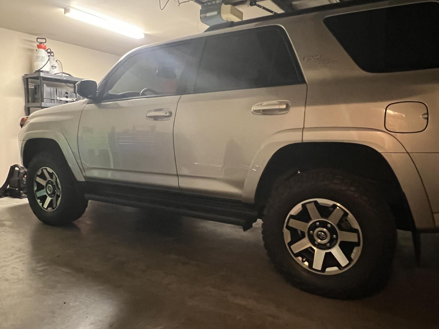

We installed 275/70/17 and Bilstein 5100's all around @ 1.75" in the front and their 1" spring in the back with a 10 mm trim packer and Ride Rite air bags. The photo was taken after a trip around the block and the airbags at 20-25 lbs. (leak testing)... oh, and I hadn't put the spare tire back on yet.
After a couple hundred miles and some settling, and the bags at 5-7 lbs. the forward rake measured at the frame is 1" while the wheel wells are just slightly under 2" (level at the wheel wells is reverse rake). I prefer a little forward rake as I deplore reverse rake, and we load up and pull a pop-up all summer.
But I digress. If I pulled the 10mm trim packer (3/8" +/-) I'd be at roughly 1/2" of rake at the frame. That's pretty darn level.
The wife and I did the install ourselves using the "compressor-less" method and it worked like a charm. In addition to the price of the Bilsteins, rear springs, trim packers, and airbags all we needed was an alignment. Obviously some 1" spacers in lieu of the springs would knock $100 - $150 off the bill, but all in all, we were somewhere in the $900 range.
A mild lift, additional travel from the shocks, and we got rid of the boat-like handling which was enough to make you sick on our twisty roads.
Now we went with 275/70/17 as a compromise given our altitude, steep grades, and the fact that we use the T4R to pull a trailer. That said we did not need to do any cutting. However, the lip of the front bumper is as close as I would want to push it and we may go ahead and do the "pro cut" for good measure. I'm fairly certain that we could have stuffed 285s under it as well with the pro cut and either removing or modifying the front mud flaps... of course that is largely due to the offset of TE wheels.
When you hit Colorado give me a holler, we'll hit a trail or two!
