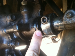

1. Leaking power steering fluid where the shaft enters the gear box (see photo below). How do I go about replacing the seal where the fluid is coming out? I ordered one (housing gear box seal?) and it's in the mail right now...

As for the seal, take pics of the box when you take it apart, I'm sure someone can show you how to pull the seal out and put the new one in.
Hopefully you don't have to disassemble the whole box to get to that seal, I've seen a tutorial on the little balls that you have to put back in to make it work again (or was that the pump? I forget...)!
