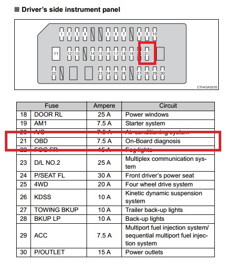

My OBD port is not working
I bought this OBD II adaptor from Amazon.. Plugged in under my 2002 Toyota Corolla and the red light lit up.. Plugged in under my 2010 Toyota 4Runner and nothing happens. No light no feedback. All lights in my car are working including the cigarette lighter. I don't understand what could be the reason.
Tried looking for the OBD fuse in the fuse box but could not figure out which one it is.. So please help on the fuse location or anything else i would need to do!! :(

So the Amazon link that was posted in the earlier post, It arrived today and thats not working either.. So I am assuming its something to do with my car. I just got the Inspection done few weeks ago, is it possible that they disabled the port?
I doubt they disabled the port, not even sure if that's possible, unless you mean physically disabled it by breaking it, lol.
Have you checked the fuse for the OBD port? It's in the under the dash fuse box. See attached diagram below, please report back because I am curious myself :)
As Suspected.. The fuse was removed.. replaced the fuse and got it working.. I have a techstream software but it does not work with the OBDII adaptor that i have.. Will have to get the mangoose obd II scanner..
