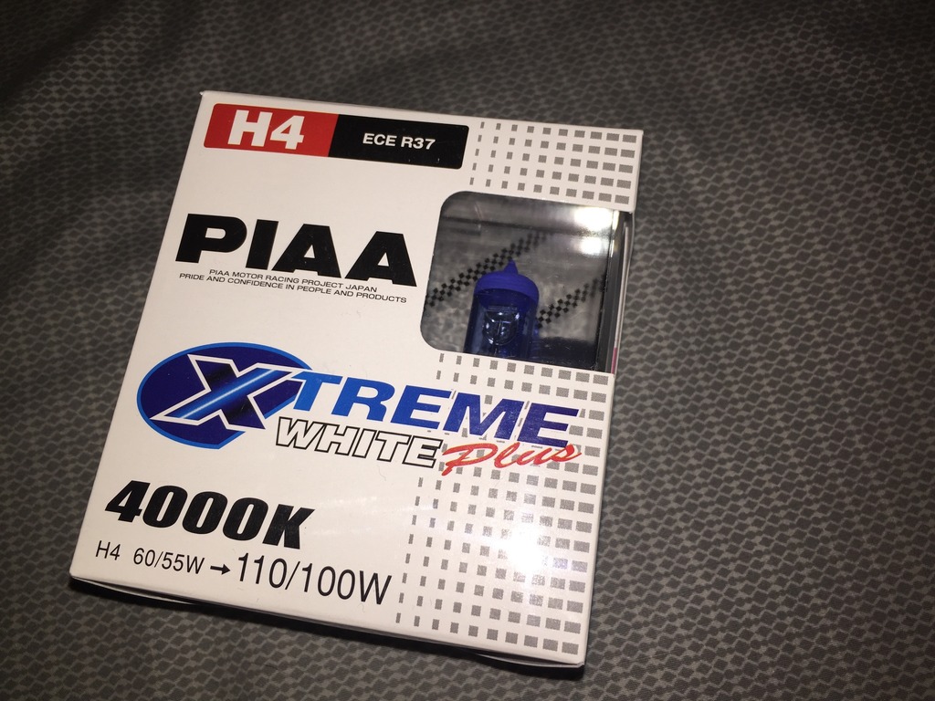

I swapped out the stock halogen bulbs for some fancy Piaa Xtreme white bulbs a few years back and I liked them a lot but they didn’t last even a year.

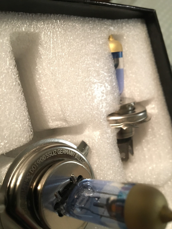

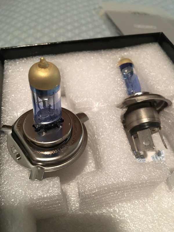

So I went the slightly cheaper route after that and just picked up some SYLVANIA 9003 SilverStar ULTRA Halogen bulbs from Walmart and called it good. These bulbs weren’t as good as the Piaa bulbs, but they didn’t cost as much either and I could return them to Walmart if they didn’t last very long.
SYLVANIA 9003 SilverStar ULTRA Halogen:
Fast forward a couple of years and the Sylvania bulbs did “ok” I guess – but I wasn’t ever really happy with them, so I started considering the OEDRO H4 9003 HB2 LED headlight bulbs that everyone is talking about in another thread.

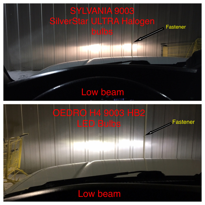

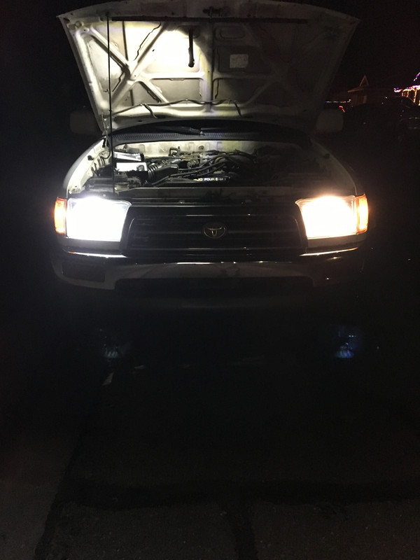

One of the things I did to be sure that I wasn’t going to blind other drivers with these headlights, was to immediately scrutinize the beam pattern and make any housing adjustments if needed before driving.
Under identical conditions about 10 minutes apart from each other, I took before and after pictures from the same spot with the low beams on the back of another vehicle at a normal distance (if driving) ahead of me. Nothing else changed but the bulbs.
As can be seen in the picture below, the beam pattern while “whiter” than the halogens, did not really change in any significant way that I could see. I studied the beam pattern pretty closely both in person and in the photos and saw nothing that alarmed me or made me think that these were not aimed well or otherwise inappropriate for these headlight housings.
I felt it was safe to drive with these LED bulbs without blinding anyone, so the next part of the test was taking a picture of the beam pattern on a wall both before and after the bulb swap. I took the first pic a ways before starting the bulb swap, so there was probably an hour between pictures and the shopping cart moved ( I was too lazy to reposition it .) Also note that the cart was closer to the wall in one pic than the other. This kinda skews the perception a little, but the parking spot and distance to the wall are really pretty consistent. The cart moving just makes it look like it’s not in the same spot.

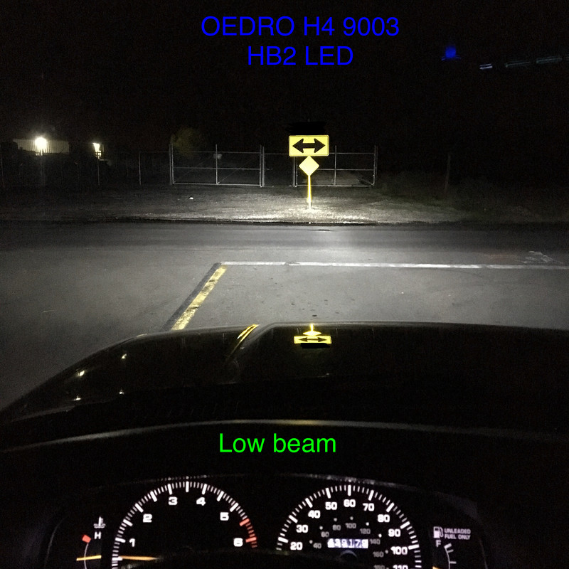

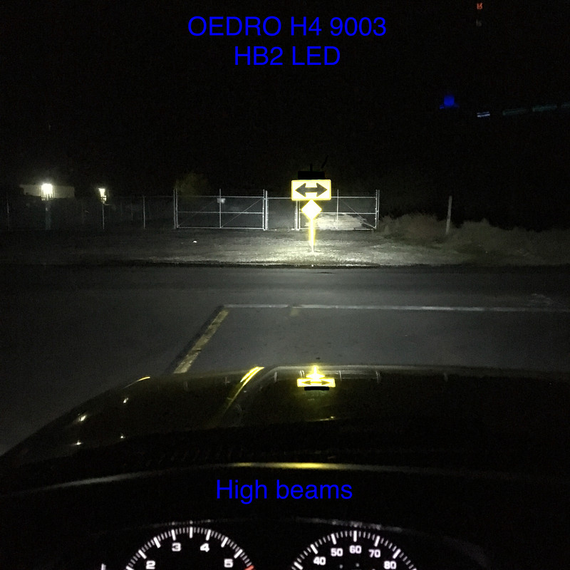

I chose the back of a store for this test and while the shopping cart had moved in the time it took me switch bulbs and return, you will see I pointed out the little fastener for the rain gutter drain-spout running down the side of the building (hard to see as it’s painted the same colors). That fastener is a good indication of the differences in beam height as all other aspects are nearly identical (shopping cart aside of course.)
Here are the differences in low beams:
Here are the differences with high beams:
The following pictures are of typical intersection street sign in the middle of nowhere. I edited out the street name so those pesky ninjas with their creepy black helicopters can’t find me again ... but other than that — not edited in any way. Same for all the rest of the pics too.
Low beams:
High beams:
These headlights have a very definite cut off. It’s actually a bit lower than I prefer and I may actually aim them up a little if it annoys me too much. Also interesting in that the cut off is actually in an equal U shape where the ends of the “U” are the sides of the road as opposed to a more typical // patern. You’ll see what I mean in the picture below. While blurry, it gives you a better idea of the pattern it lays on the road.
Here is a picture of both the LED and the Halogen bulbs together for a color comparison.

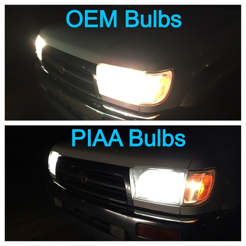

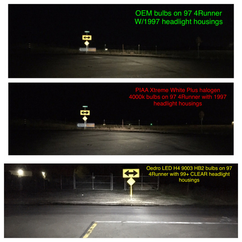

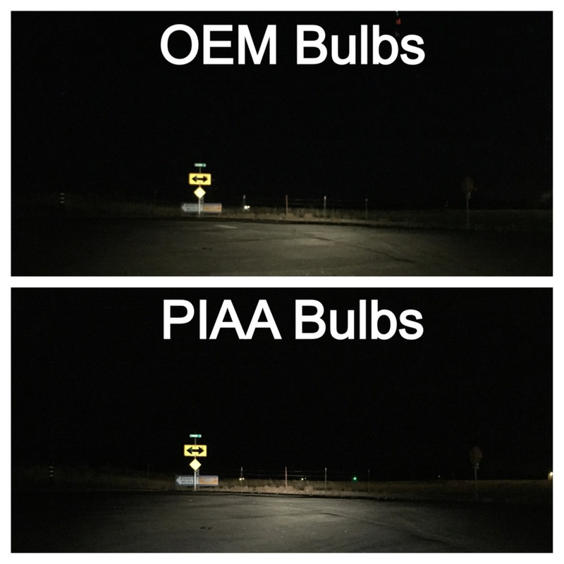

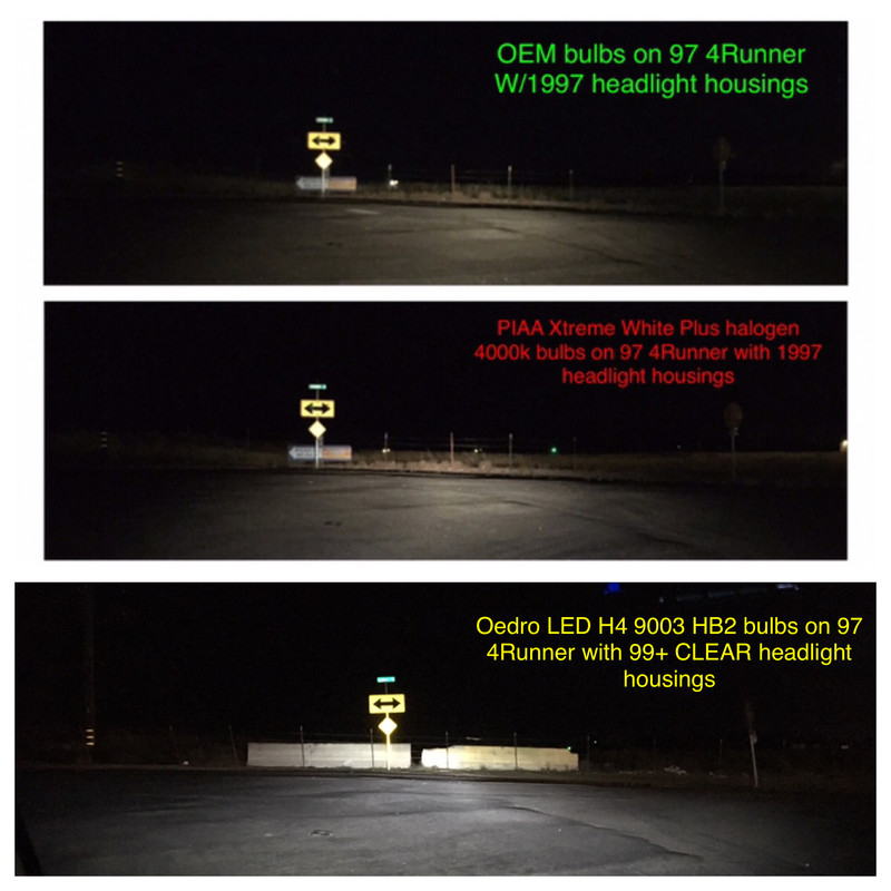

Ok here’s a comparison picture of OEM bulbs, Piaa Xtreme White Plus halogen bulbs and the Oedro H4 9003 HB2 LED bulbs.
A couple caveats first. The OEM and Piaa pictures were taken in 2015 on an old older iPhone than the Oedro picture which was taken a day or two ago and on a newer iPhone.
Also, the OEDRO picture is of a different road sign and from a different distance than the OEM and Piaa pictures.
So no meaningful comparison can be made TBH, but it still is interesting to compare the pictures just for shits & giggles.
I may go back to that original road sign and take a pic with the Oedro LED bulbs. While years have passed since the first pictures, it may still prove insightful to more properly compare the Piaa bulbs and Oedro bulbs.
***also, I’m not sure if the pictures with the OEM and Piaa bulbs were of high beams or low beams as I didn’t note that in the pics. So who knows, but the Oedro picture in the comparison is most definitely low beams.

One thing to be careful with posting iphone pictures is the exposure. Unless you are using manual exposure, set to the same level for both photos (and maybe you are), then the comparison between halogen and LED outputs is not going to be objective. With the much higher lumens of the LEDs, the camera will shorten the exposure and will not show any of the bleed off light.

You are absolutely correct about the phone cameras and the exposure. I tried to keep every thing as close to the same as possible, but I did not manually adjust the exposure.
Ultimately though, no picture is going to really capture the lighting in the same way as seeing it in person. Just too many variables to control in real-world conditions. I think the biggest value in everyone’s review is what they think of these particular bulbs in our particular headlight housings — the pictures to me are just supporting evidence.

I’ve had this picture now for a week or two but forgot to post it back up.
Keep in mind there is 2-3 year difference in the pictures and the phone is newer. While the sign has been moved and barriers put up (guessing some drunk ran the old sign down) the latest picture with the LEDs is pretty much the same as the older pics. These Oedro LEDs lights are quite a bit brighter and the pictures show this as well.
That's a pretty big difference man!! Seems like these bulbs deliver a pretty good bang for the buck
