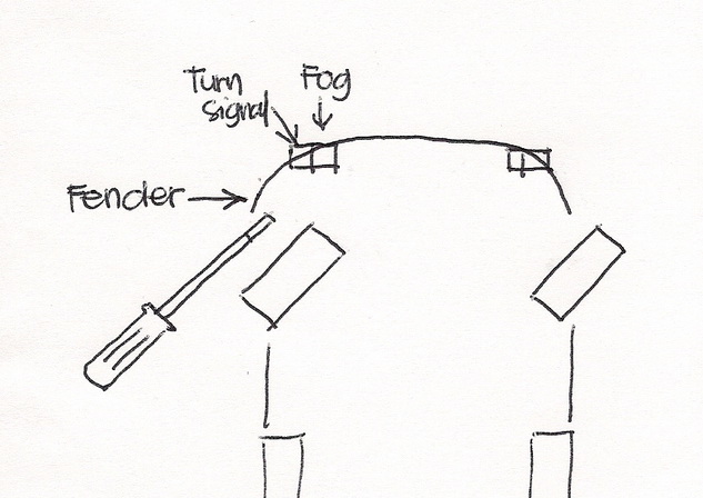

I accessed the fog infront of the wheel/tire, I removed 2-3 screws of that plastic sheet(I don't know how to call it)..
Here is my stupid access to the fog:

Thanks, going in from the fender liner proved to be the trick. Took about 10 mins start to finish, so not bad at all.
In case anybody else has this question, there are two bolts with 10mm hex heads holding the fog light in, one on the inboard side, one on the aft/back side of it. You could probably get to it all without taking the fender liner partially off, but it was easier getting to the back bolt through that opening.

The claw fitting seemed like a *****. And it was...in the end, I wound up putting a long thin flat head screw driver between the fog and turn signal and wiggled it as I pushed from the back...popped out...
