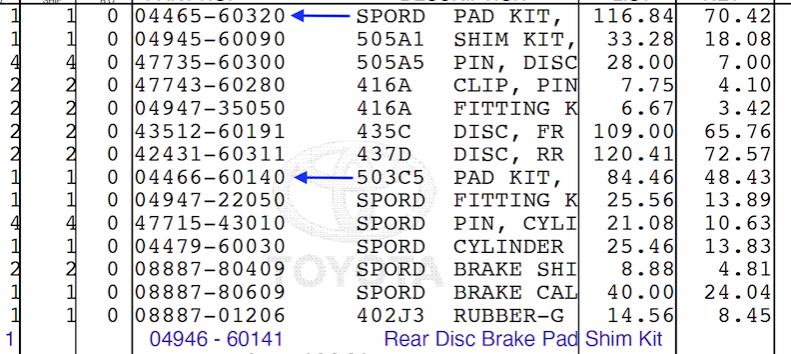

OEM for pads and rotors (and shims!) Make sure they are the original originals, Toyota carries two lines, one that comes from factory and one that's stocked in dealerships (has AZ in the number). I had everything done last summer; pads, rotors, shims, pins and clips.(even got the og grease) Can't go wrong with OEM.

Thanks for the video and parts list! Of those parts, what is actually needed for a standard front brake service? Planning to do pads, rotors & shims. Wasnt sure about the other pins, springs & fitting kits.
It's hard to tell whats what in the toyota diagrams, certain part numbers are just not listed. I haven't personally done my brakes before so not sure exactly what standard items should just be replaced. Any input's appreciated!
