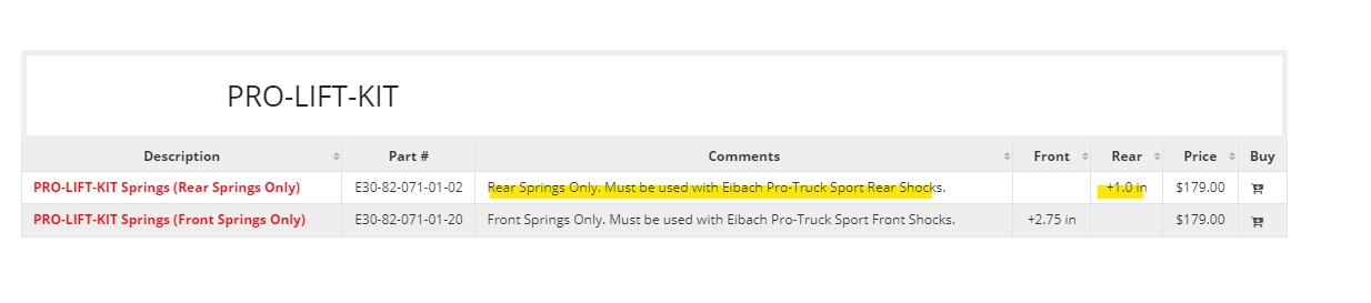

I agree, we can use the OEM shock on a slightly longer spring. However, I have to call out Eibach for mixing marketing and technical info on their website. Below Eibach states to only use their Eibach Pro shocks with the Pro lift spring. Not true until I hear why..
