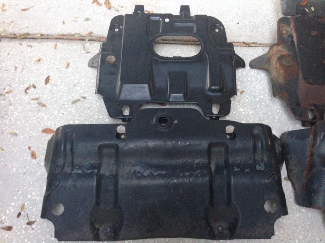

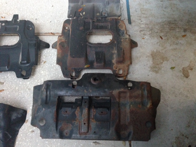

As my signature says, I have a 2005 Limited V8 4x4. When I bought the vehicle it had quite a bit of rust on the front skid plates. I found a local salvage yard with a 2004 Sport Edition V8 4x4 and got the skids off it for a deal.
Went to put them on today and they are very different. Anyone else notice this before? Did it change when they updated the V8 or is it a difference between the SE and the Limited?
2005 V8 Limited
2004 V8 Sport

V6 and V8 do not matter, the one with screens is from 4wd and the one without screens is from a 2wd.
I thought I got them from a 4wd but now I'm second guessing myself after this thread. Guess I need to go back.
Local "high end" salvage yard was expanding to a warehouse. They had just received approximately 500 additional vehicles, 6 of which were 4th gen 4Runners, untouched. 4 were V8s, 3 of which were 4wd.
Probably just a simple mix up, I believe the screens for the 4wd is to aid in cooling of the front dif. since 2wd's don't have one it was probably cheaper to produce a non-screen skid plate for us 2wd guys.
