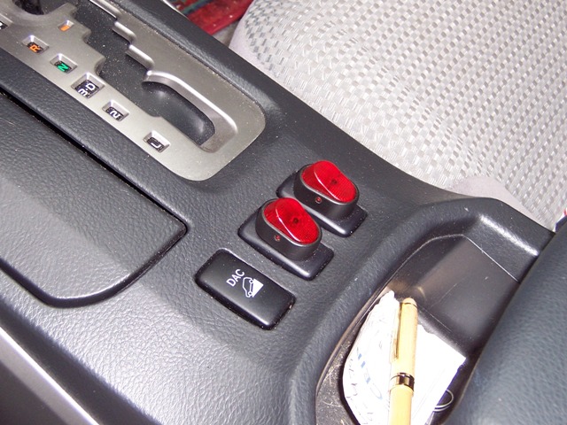

I prefer this switch it matches the color of my neck.
