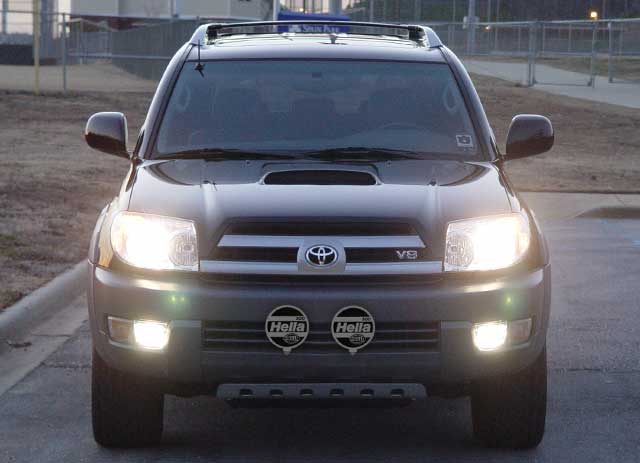

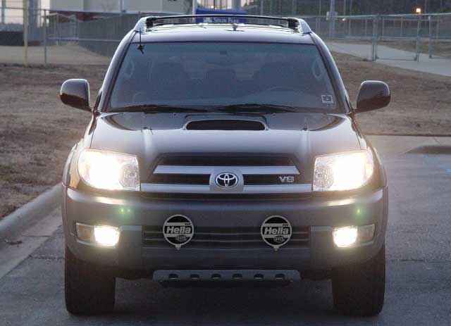

Here is two chopped versions. I can't decide if I like 'em spread apart of close together.

I like them spread out. I THINK I really like how it looks.
I am just worried if it will look to cluttered or outta
place. What does everyone else think?
