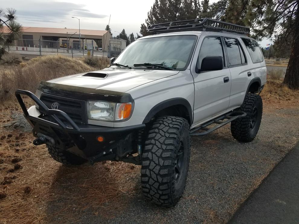

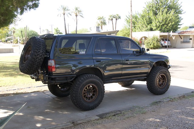

Since there is a thread for 35's I thought I would get one going for the 37's crowd.
Looks like your rocking the stock lower arms at least. What are you running for your suspension, especially for the front?
Stock lowers and SPC uppers. Bilstein Tundra 5100 and TRD springs front, Superflex rear. 2" body lift and sawzall/body saw
Looks good! How does it drive with the 3RZ?
Much better since I swapped to 5.29s. Still doesn't like the mountain passes but the only time it did like passes was when I first got it and it had 225/75/15 tires. It gets driven everywhere and has been to Moab/CO and back twice along with lots of other road trips.

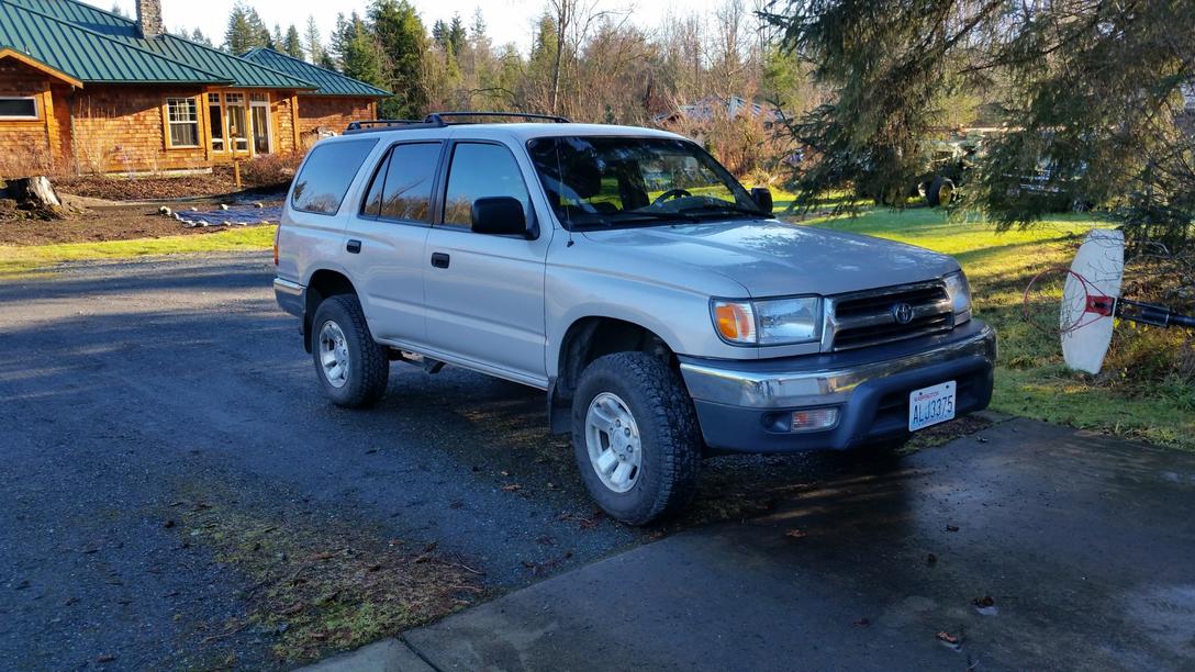

Wasn't it cute?
LOL. At least the running boards where off. Mine was bone stock. Now, not so much.
