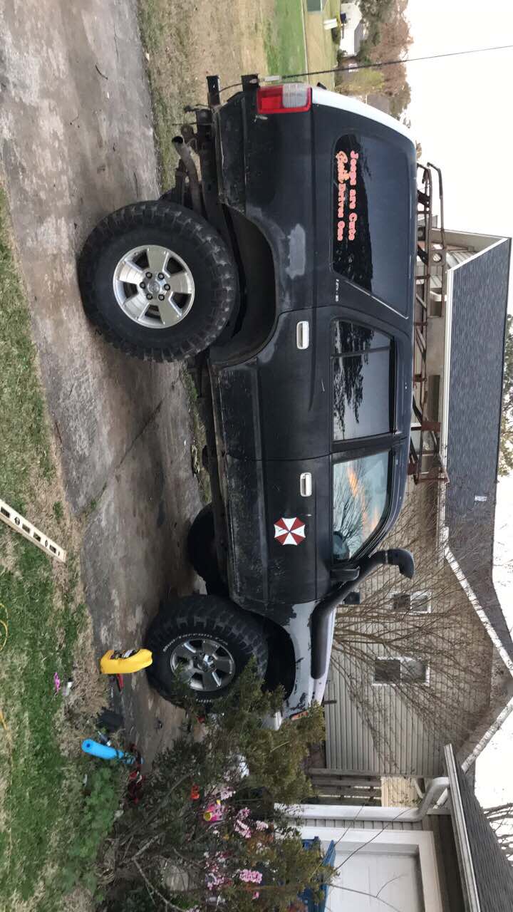

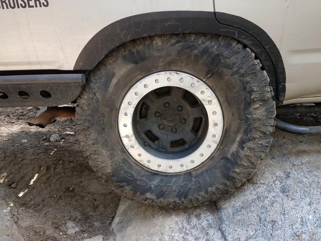

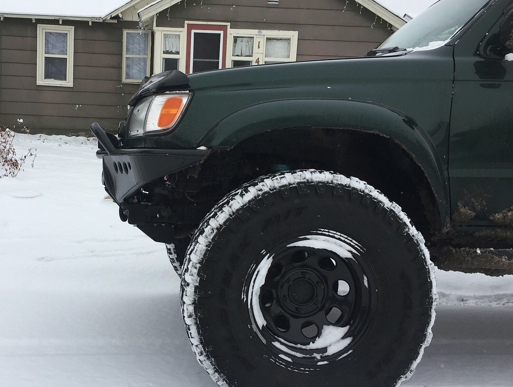

Honestly I feel like the front end needs another round of trimming and cutting. Although it lasted a week in Moab with almost no rubbing in the front, I wasn’t going to hard on it as it was also my first run on the new setup. As of now the fender is cut to right below the mounting holes for the factory flares. Then the flare itself is completely gutted on the inside. The flare needs to get cut again at the bottom of the rounded top section. Past that I’m relatively out of options besides remounting the flare higher.
The rear is bone stock. Needs some trimming on the flare sections that mount to the rear door but apart from that spot I don’t rub at all on the flare. I kept the back tighter than most by running 4.5 BS wheels. It actually tucks inside the fender lip.
