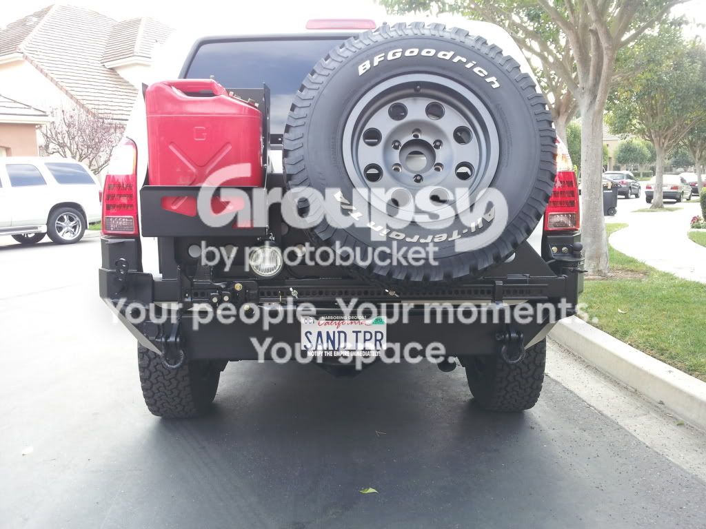

You are correct the rear muffler/ tail pipe seems to hit ... Stock ... and With After market bumpers ..as with anything ,you change front /rear bumpers due to limits with stock stuff... You do the same with aftermarket ..go find the limit as you see in the pic even with added rear clearance if you dont move the exhaust it will still get smashed ..on the front you get after market bumper for more clearance then you now need full skids because you can go more places then sliders etc. But they are well worth it if you off road alot.

That's my point, with the front and rear you're good to go. I was just wondering when only the front is installed if it really helps offroad.

This is why I opted to replace my rear bumper first...my backend was bottoming out a lot when off-roading. I ordered a CBI rear bumper with swingout and will hopefully have it by end of May.
I also damaged my tailpipe. I plan to order a Gibson catback exhaust and have it aiming out the side instead of the rear.
Later this year, I'll replace the front bumper and get a winch.

I am all for aftermarket bumpers. However, the ability to run larger tires is not a huge advantage. You will run into problems with the body mounts in the rear of the wheel well and the washer fluid resi in the front right before you have issues with the stock front bumper.
A rear bumper will allow you to carry a full size spare which is required for any serious off roading.
