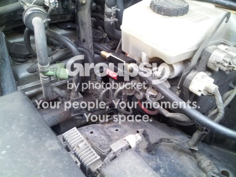

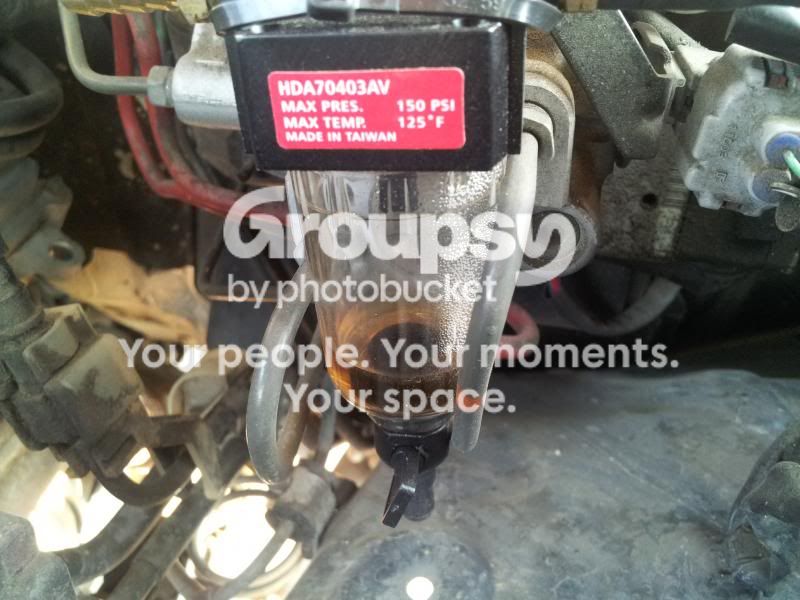

Did the home depot husky catch can for $12 about 40k ago. It definitely catches oil and stops it from entering the manifold.
Do you have a write up???? you got a V6 or V8?
Sorry no write up. You just need a husky air compressor filter in the tool section of home depot. 2 1/4ntp to 3/8 fittings from plumbing section home depot. 4 ft of 3/8 hose auto zone. If you let it fill all the way, the ventilation pipe on the intake side (passenger side valve cover) will suck in lots of oil and will have blue smoke show under load.

About 600 miles on this dump. Catches about 3 ounces per 1000 miles and at my 5k oil change I am about a quart low. I can feel the motor running smoother with no oil in the charge. Great mod and still emissons legal depending on how you hook it up.
