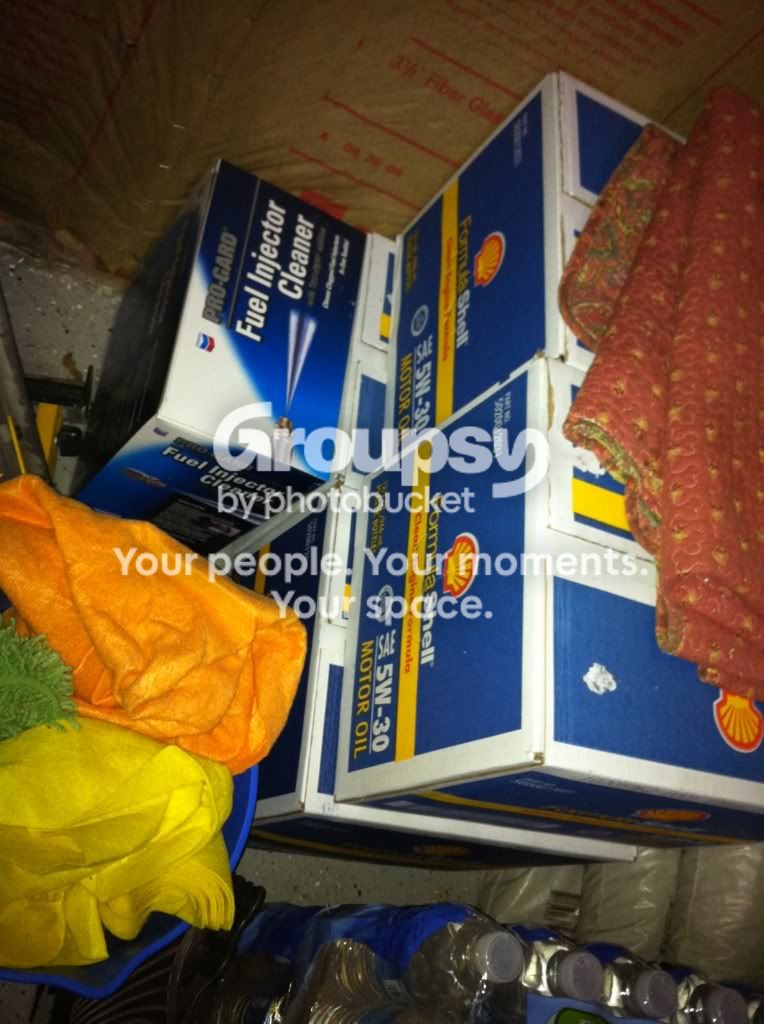

I run shell 5w-30 or 10-30 depending on my mood from Costco. They were $20 for a case of 12 quarts so i bought 4 cases. :D
a50b2ee8.jpg~original

short answer.
contrary to popular belief their really is no scientific proof that fuel injector cleaners actually work. Don't use diesel blend use 5w30 oil specified by toyota
Is your truck running good? why do you want to use injector cleaner? Are you having performance issues? If so you need to address the underlying issue to fix the problem.
