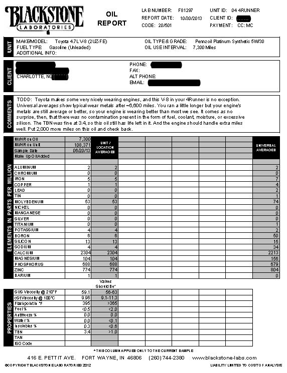

OCA after 5 months 7300 miles, lots of highway, some heavy towing. Hope you can see the file. Looks like pretty good results. Sample date was actually 10/20 not 6/20.

Nice. Less oil changes equals better for mother earth. A 9500 oil interval is great. I have an 04, and immediately switched to full synthetic and went to a 7500 oil interval. Seeing this makes me consider 10k.
Also makes you see how newer engines, when designed, can absolutely go 15k intervals.

I use the exact same oil and from what everything I've read about the Toyota 4.7 V8...
It's an engine that is very 'easy' on oil.
The Pennzoil Platinum oil is a very robust oil and the additive package is solid. I am also running this oil and in my v6. My Blackstone results at 5k miles were excellent. They also suggested I try 6500 miles as my next OCI. For me the oil is cheap enough that I change it around 5-5.5k miles for peace of mind. But I would have no issues pushing this oil to a 7500 OCI based on my test samples.

Thanks for posting this. It proves my point that the 3,000 mile interval Mobil 1 only people are literally throwing cash down the drain.
What's your interval if you don't mind me asking?
I started using Pennzoil Platinum about the 6-7K mileage after break-in.
Since then, and being that I'm on an extended warranty, I change oil and filter every six months or 7500 miles.
No added oil between changes, just the Platinum 5W-30 and a good filter like a Pure One.

I'll have to do an analysis at about 10/15k with the Amsoil Signature Synthetic I am using, they're saying it will last until 25k under normal use and 15k under "severe" conditions (though both are withing 1year according to them).

The Pennzoil platinum detergent package is great. If there any crap buildup in the engine it will clean a lot of it out within a couple oil changes. When I spoke with the Shell chemical engineer he suggested using the Pennzoil platinum for 3k OCI for the first change after to going to Pennzoil platinum then going to 5k OCI. At that point sending a sample to Blackstone for testing to determine the best OCI.

I personally will probably change the oil around 10k-15k and send a sample in to verify how well the oil is holding up in my engine, I personally feel I am pretty rough on the 4Runner vs. most people.

Like I said, I'm going to get a sample when I hit 10k on my oil and send it in to have it analyzed, if they say I'm changing too early then that's good enough for me combined with Amsoil's data. But you're right all vehicles are different and even Amsoil says "Severe" driving results in a gaurenteed 15k OCI vs. their normal 25k advertised on the bottle. Not to mention they still say "1 year OR 25k which ever comes first" so there's still a concern about the oil aging.
I wouldn't get an oil analysis at 5k miles and based on it make a determination that you can drastically extend your oil change interval. Too many factors and variables between each oil change. You could do an analysis 5 oil changes in a row and get 5 different reports...each recommending a different oil change interval.
Engine oil analysis are good for ONLY that oil change. Engines age...and as they age other things wear out. You also may not drive the same or have have the same commute between each oil change..
Recommended oil change intervals are determined to give you the best of keeping the engine in good condition over many years and at the same time not having you to change your oil too often.
