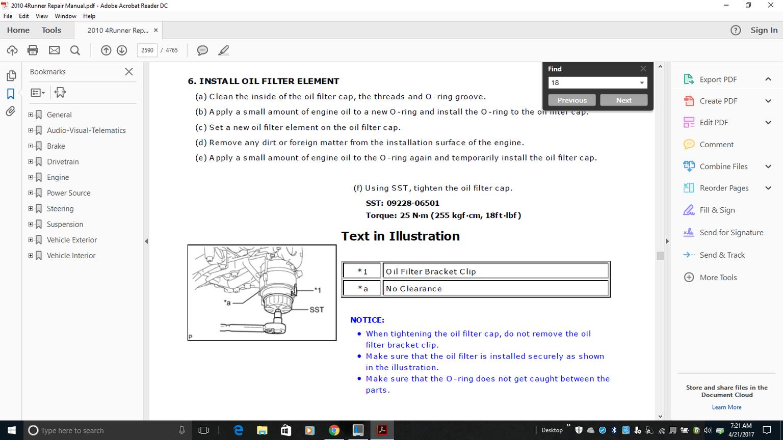

Oil filter section of 5th Gen Factory Service Manual provided by member nashman69 shows 18ft lbs. torque for the oil filter housing.
I replace and lube well the big gasket at each oil change. That said, the filter housing always requires some grunt-groan to get off.
