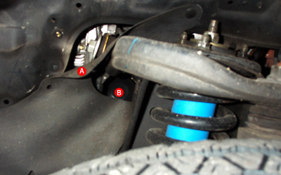

You can access the oil filter assuming you have a 3.4l v6, through the driverside wheel well by moving a flap of which I can hopefully get you a pic in just a second.
