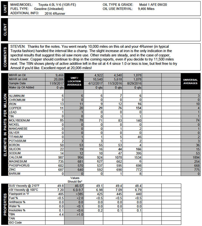

My 10,000 Mile Oil Change Results
Here is my Blackstone Labs report from my last oil change (approximately 9,500 miles on the oil).
I used Mobil 1 0W-20 Advanced Fuel Economy (AFE) with none added during the interval. I was a little nervous about going so long without an oil change and was really wondering if Mobil 1 could stand up to it -- if it was close I was going to switch to Amsoil Signature 0W-20.
I do need to order some new Amsoil oil filters -- they're expensive, but at least they give you their filtration ratings. I had to get an STP filter for the time being.
Looks like it will be 10,000 mile OCI with Mobil 1 AFE 0W-20 and Amsoil filter for me!
thanks for your 10K mile oil analysis . just did my 7K mile oil change and I would agree 10K miles is a good time to do it.. @7K miles same oil that you use engine was exactly at the full mark on stick and the oil was slightly darker than new.
Cut open the oil filter and the pleats were still clean , toyota filters.
next oil change will be 10K miles mobil 1 0-20wt advanced ..

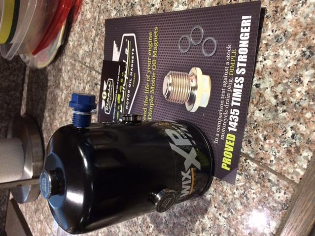

My 2000 4Runner SR5 3.4L-v6 4x4 - got its first oil change (last week), since purchasing it 1-3/4 years ago @ 8,000 Km = 5,000 mile interval.
- now speedometer at 138,000 Km / 85,700 miles
a) Pennzoil Ultra Platinum Synthetic 5w-30 / made from clean Natural Gas base stock
b) WIX XP Platinum Synthetic media filter / PS - the longer filter wouldn't thread on, so went with the shorter version
c) AMSOIL Synthetic Racing Grease, used on all the numerous jerks
d) finally Dimple Magnets / drain pan plug bolt & on filter case end
I only use Pennzoil ULTRA Platinum (Yellow Jug now) & new WIX XP Platinum syn. filter.
- I've never used extended mileage oil
- used the above in my RAV4-v6 4x4, 2000 4Runner SR5 3.4L-v6 4x4 and a 1998 Silverado 5.7L 4x4
- plus John Deere garden tractors (318 & GT262), other small engines, etc.
Last time used AMSOIL Racing grease, on Gen3 driveshafts.
- will switch to RedLine Synthetic Grease, next order: https://www.summitracing.com/int/parts/red-80402/overview/
Wife's 3.5L-v6 RAV4 oil and filter, gets changed every 10,000 Km. || equals 6,210 miles
- and the used oil still retains 1/2 its honey color
WIX "XP" oil filters is their new Platinum line / using synthetic media....extended mileage filters.
- WIX Filters XP Oil Filters 51348XP https://www.summitracing.com/int/pa...=pla-google-_-shopping-_-srese1-_-wix-filters
A WIX XP Platinum synthetic filter, is same as Amsoil Filter, re-branded || www.Filter1.com also has good prices.
- once a year I order my filters in bulk, and drive to MI for parcel pickup
My favorite oil is Pennzoil Ultra Platinum (from 99.5% clean N-Gas base stock) / Canadian Tire had on sale, few weeks ago.
- $47.98/5L Yellow Jug + HST
20 years using AMSOIL here...no more, too expensive without the extra added value proposition / competition has caught up or exceeded it.
VIDEO - Why You Should Use 100% Synthetic Oil In Your Car (This Is A Must Watch) - https://www.youtube.com/watch?v=pc1qMp0Ea7Y
I no longer use Amsoil (Group IV & way to expensive), except for Syn. grease / Redline Group V for the Transmission & Gear oil.
And Pennzoil Ultra Platinum for engine oil, made from 99.5% clean Natural Gas base stock.
- my engine oil change frequency is 10,000 Km or 6,200 miles
- Fluid Capacity: 2000 4Runner SR5 v6 4x4 https://www.amsoil.com/AmsoilGarage/internal/vehiclelookuppage.aspx?url2=2000+TOYOTA+4-RUNNER+8
RedLine Transmission Synthetic Group V - D6 ATF - gallon - $49.95 @ Summit / 30705
https://www.summitracing.com/int/parts/red-30705
- Our lowest viscosity, most shear-stable ATF for consistent operation, designed to satisfy Dexron-VI®, Mercon®SP, Mercon®LV, Honda DW-1, Toyota WS, Mercedes Benz NAG-2, ZF-LG 6, 6+ and 8 fluids
Dimple Magnets for pan ($35 each) & oil filter (4pk for $35)...quality products & Made in USA...Phone 1-704-320-0700
Canadian distributor in ON. sells them for $35 Cdn & free shipping if buy 3 products...Phone 1-905-665-7883
Magnetic Drain Plugs for Toyota/Lexus Automobiles

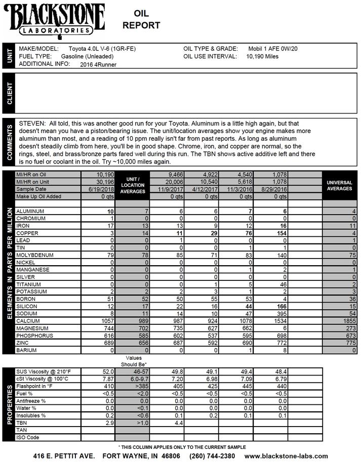

Here is my recent 10k mile OCI report from Blackstone Labs. It looks like Mobil 1 0W-20 AFE is a 10k to 12k mile engine oil. Since I live in Montana, I usually drive fairly long distances; almost never any short trips (I have a little Saturn with over 265k on it that I use for the in-town trips). I also used a Fram XtraGuard oil filter on this run rather than my usual Amsoil filter.
