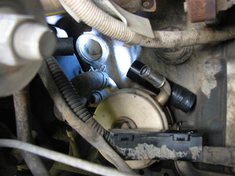

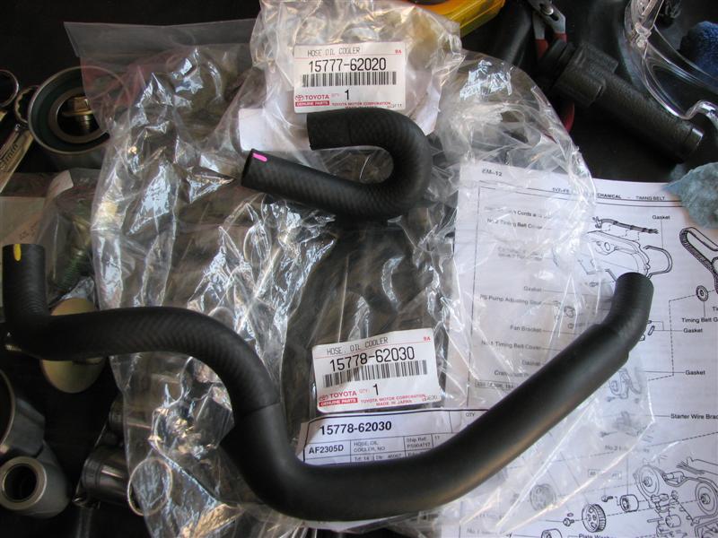

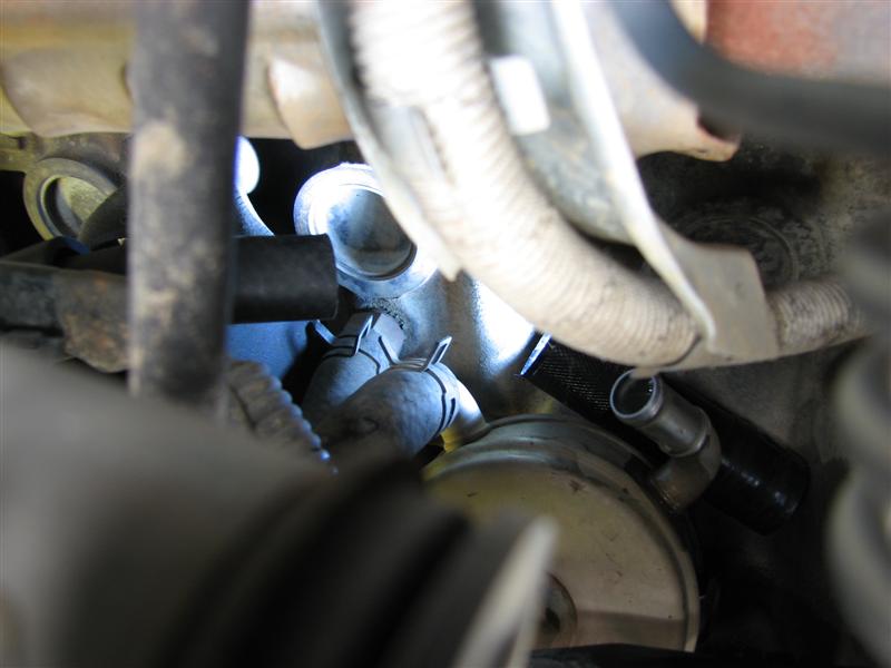

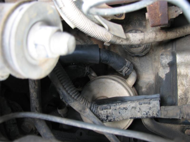

I'm in the middle of doing my timing belt, wp, blah,blah job and I also ordered the two oil cooler hoses so I could change them at the same time. Took me about 2 hours just to R&R these little bas****s.
I don't know how all you young rubber people do timing belt jobs in less than a day. I've been working on this over over a day and it's just torn down. But... I did get these little hoses changed today. You have to take off the drivers side tire and go in through the hard cover just aft of the UCA, not the soft cover we go through for the oil filter.
It's pretty much a one handed job. I got my other hand in through the soft cover side but could barely reach over just enough to put some fingers on it and help a little.
Here's some pics.
