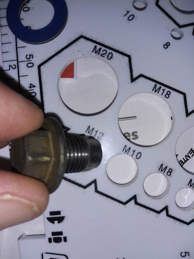

My apologies Sir. I misread your post and didn't see that you want to put a valve in. I believe [MENTION=200736]ElectroBoy[/MENTION] has the right info. Bolt size would be M12-1.25. I put a Fumoto valve on my 5th gen and this is the drain plug. So it should be the same. Sorry about that.
