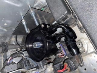

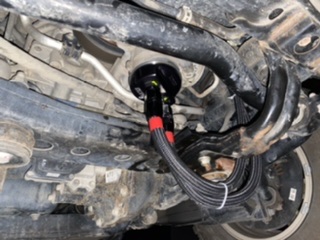

BUT, I grew so frustrated at how this oil cap made me feel like a rookie mechanic that I spent this past weekend installing a full Baxter relocation setup:

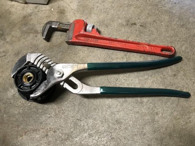

You’re in samurai warrior mode now. Get your new replacement Toyota metal housing and new oil filter and gaskets on deck and attack that busted up plastic filter.
Get a large channel lock pliers or a plumber’s pipe wrench. Engulf that plastic housing high up the best you can, and unscrew it by pulling on the wrench slowly with constant force. No sudden movements. You may need additional leverage with a length of pipe over the handle of the wrench. In addition to being cranked on too tight the rubber gasket was probably not lubed before installation and it binds.
