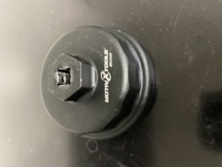

I use the MotivX removal tool for mine and it's worked flawlessly. I always recommend to use the socket over sticking the 3/8" in. Just get more control on it that way.

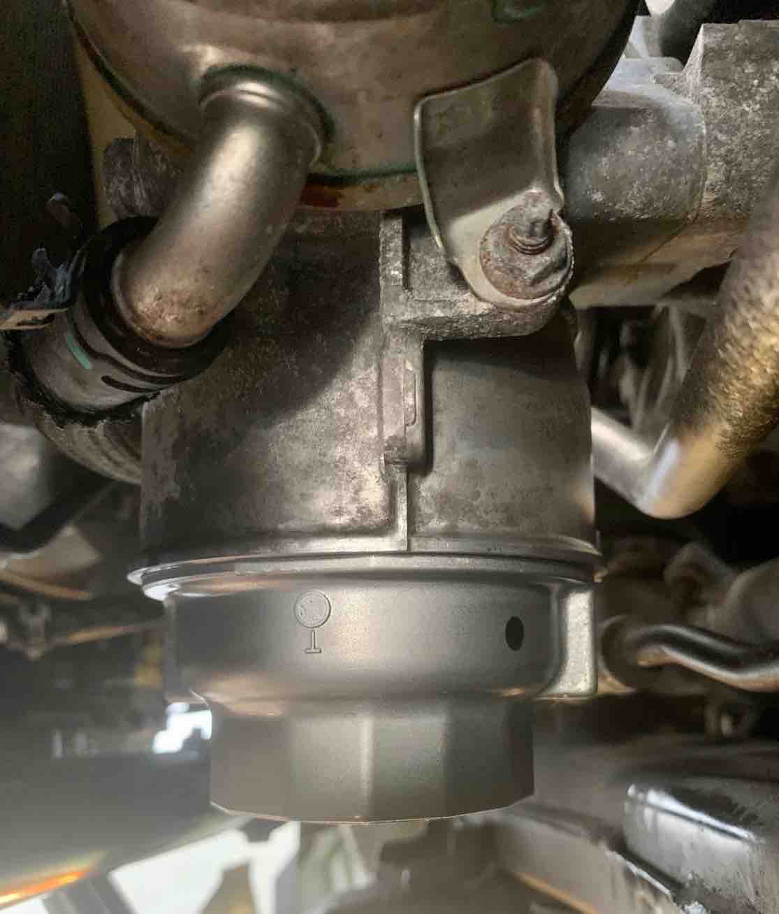

I put an aluminum one on yesterday for peace of mind, never had an issue with the plastic one other than taking it off sounded like it was about to crack and I always caked the threads and gasket in oil. The aluminum seemed to thread on much more precise, I was able to hand tighten it all the way then snug it appropriately, and it stops hard as it should no way you can crank it tighter as was allowable with the plastic housing. This part should have been used on this motor in my humble opinion.

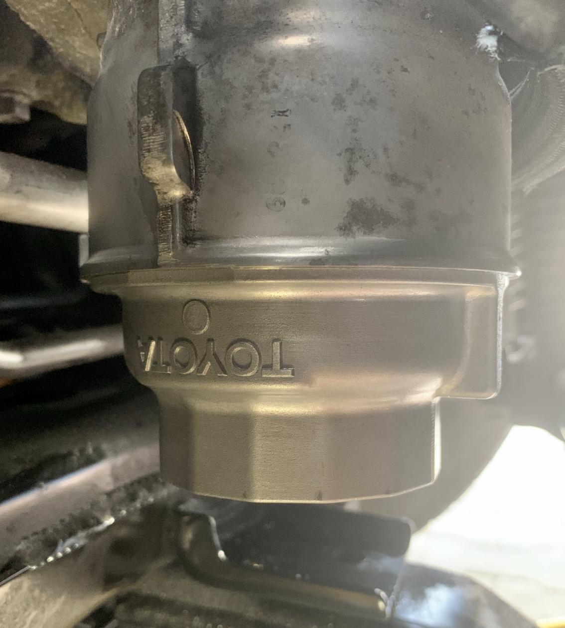

Played this game again today and only wish Toyota could have made it more complicated. I must have torqued the "filter drain cap, plug thingy, P.O.S" a bit to much and was turning the whole housing. Grabbed the trusty vise-grip oil filter wrench and made short work of separating the two pieces.I Really need to convert it to a normal filter.

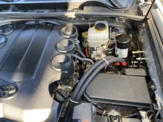

BUT, I grew so frustrated at how this oil cap made me feel like a rookie mechanic that I spent this past weekend installing a full Baxter relocation setup:

If you search “Baxter” you full see a write up by another member, but here’s a quick shot of my finished product. I just did my first oil change since moving the filter and I was very happy about it.
Thanks. The location of your mount turns it to an inverted filter. What happens when you unscrew that filter; where does the oil go?
Thanks,
Thanks,
Good question. The mount has a trough that catches the oil from the filter when unscrewed. It’s a very intuitive design. My first oil change with this setup resulted in not one drip of oil. Imagine that!
I'm in the same boat. The oil filter housing will turn, but I can't get the metal plug out. How did you get it removed? Thx.
I was able to hit the wrench with my hand sharply and that action broke the filter housing drain plug free. When I just tried to unscrew it the filter housing unscrewed.
This looks fantastic!
Is this the product you used? If so, does it come with the converter and hoses/fittings?
Inverted Remote Oil Filter Mount - Baxter Performance
