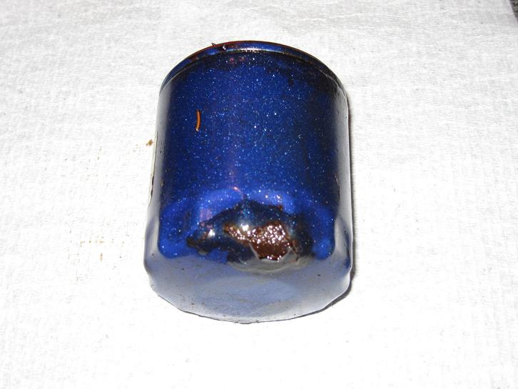

here is one pic....after looking closer at the filter..is seems like the inside under the paint started rusting in numerous spots. this was the worst one, this was the point of the fliter that was closest to the ground..

I'm really tempted to saw this thing apart and see if there was any actual rust inside the fliter which could have effected the oil...but then maybe i should wait to see what Purolator says
Sorta reminds me of the problem the 70's Mopar's had with their sheet metal rusting from the inside out because of the impurities in the recycled metal they used. Unless you do a lot of driving in salt water, I can't see why it would have rusted out that badly.

Internally elevated acid (TAN) in your oil is extremely corrosive. If were talking about 1+ year between changeouts, I'm guessing that the wall thickness was comprimised (internally) due to chemical (acid) attack. The fact that you live in Northern NJ and get some sloppy weather in the winter with chunks of ice, snow and salt getting kicked up underneath the vehicle increases the probability that something impacted the filter from the outside.
Both of these scenarios could have been happening (happened) simultaneously to provide the result you are left with. Just my 2 cents...good luck and please let us know what Puralator says. :)
PS. Maybe change your filter more than once per year from now on? :bash:;):
Holly mother of god! No filter should do that. I would be mad as hell at the place that installed it. It looks like that one sat on shelf since Cold War and then got put on your rig.
