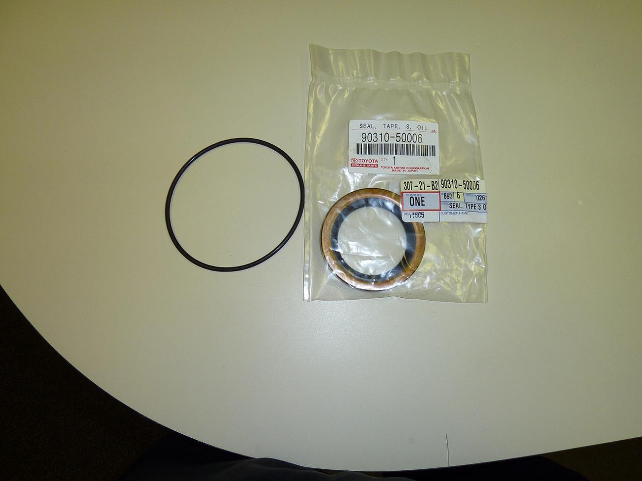

So My 4runner has had a oil leak for some months now. It was rear D/S wheel seal ( i believed) So i replaced it 3 times, but it still leaking.
I got the inner wheel seal and my first time i warped the seal, but it took only a few day to start leaking, so i replace the seal again for a second time being a little more careful, but prob got warped cause it started to leak again. On the third attempt i act use a big socket and drove the seal in and also replace the O-ring and a few days later its leaking again. this stupid leak is holding me up from putting my rims on. has anyone has this problem and how was it resolved.
Q. Could it be my wheel bearing going bad? well thanks for any help, i attached pics of the parts if that helps.

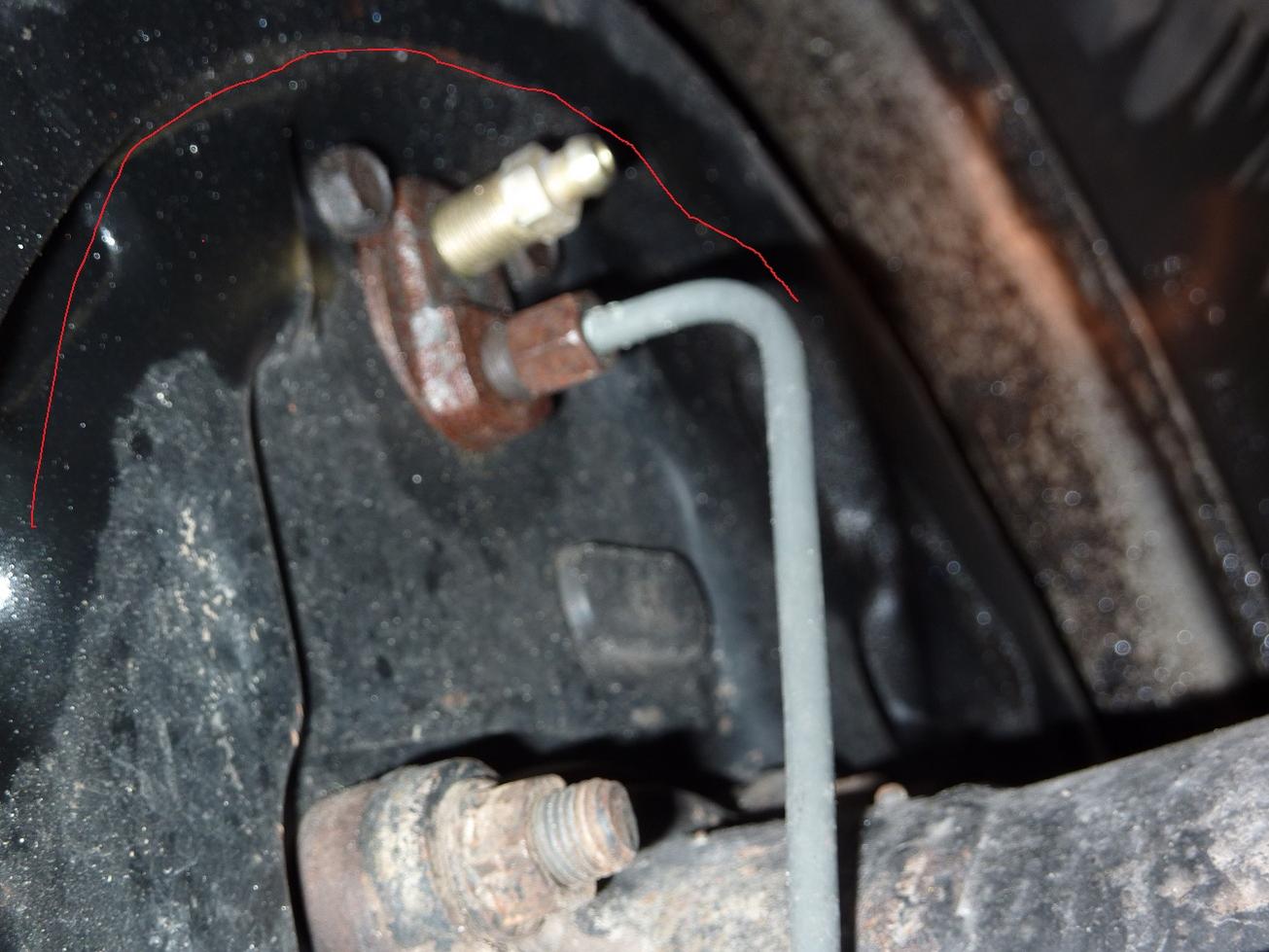

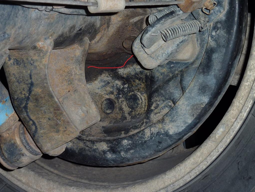

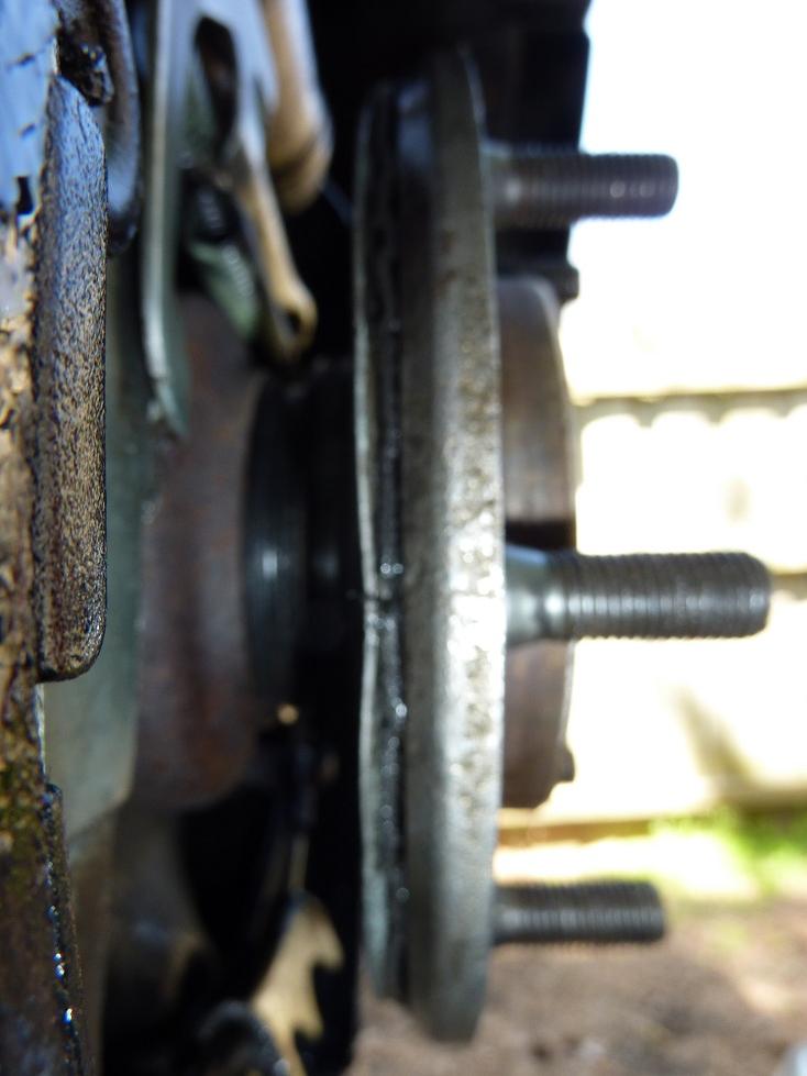

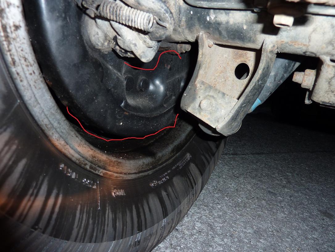

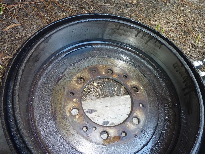

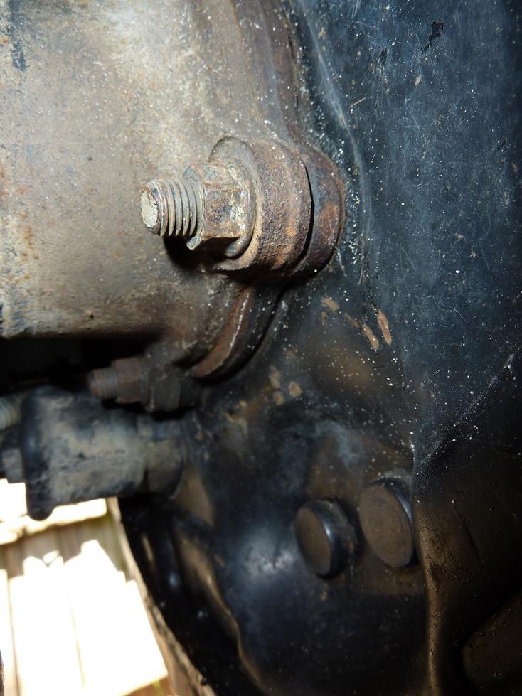

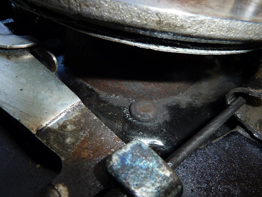

yeah, well that could be my problem then, because the oil doesn't leak out from where it would be if it were a inner wheel seal. added some more pictures. sorry its dark out.
1st pic wetness by break bleeder, but its not break fluid
2nd pic no evidence of inner wheel seal cause the area would be soaked in oil.
3rd pic long line is where the oil leak is previlent
4th pic driver side.
so ifs its the diff. breather what do i have to do to fix it?

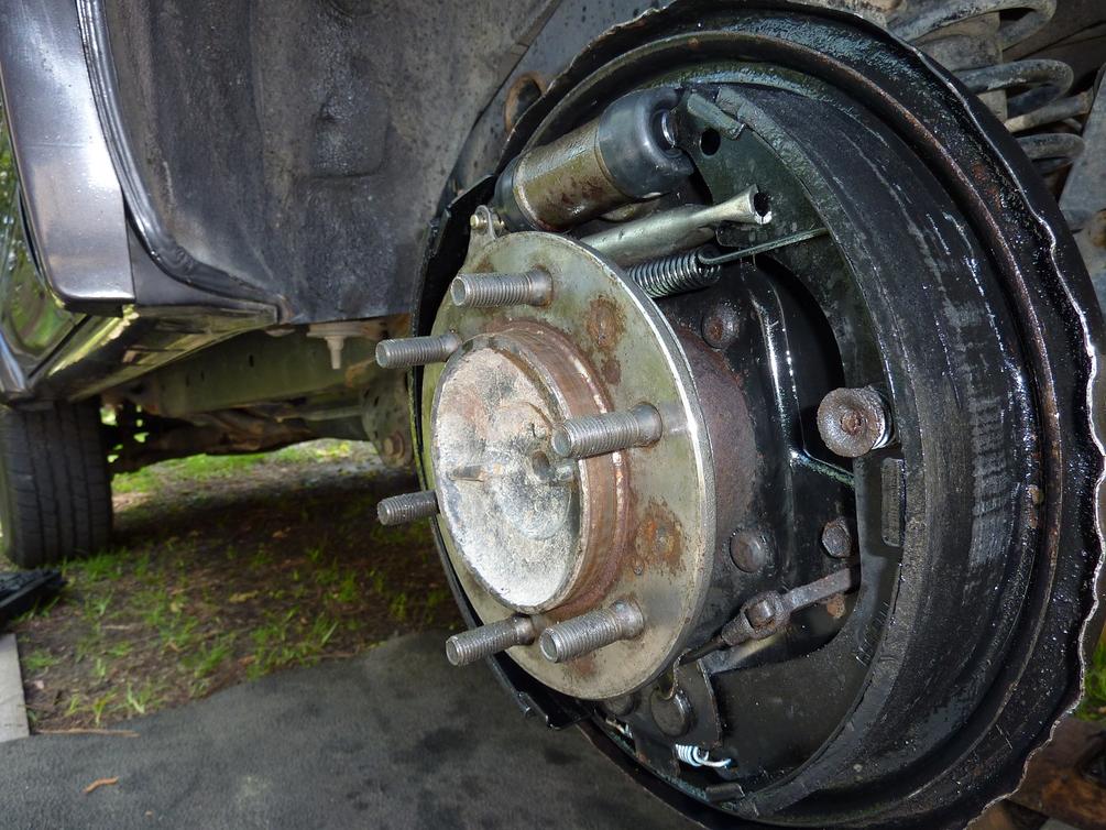

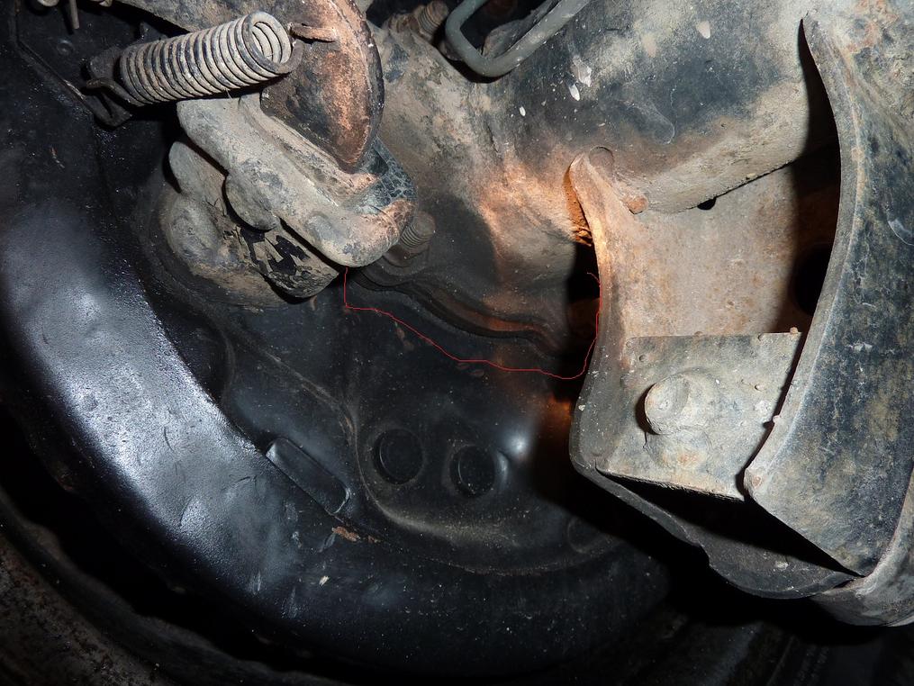

Well dude, its back again. But i am absolute sure its not the inner wheel seal. and the breather valve seams to be working ok. When i cleared the breather valve i also drained the rear diff. and re-fill with 2.8quarts. I can't tell where it could possible be leaking from. I added a few more pics hope you can prob tell where it may be leaking form or whats the problem
pic are to show that inner wheel seal is not leaking

Now I wonder if the part of the axle housing where the seal seats into is boogered up and not allowing it to seal. It's hard to say without being able to see it in person. That sucks.
If the axle bearing has gone bad it will allow the axle to move up and down and front to rear as well. This allows the axle to sort of beat up the seal. How do the leaky ones look? Is the rubber deformed or torn?
Go ahead and pull the axle shaft. Spec out the bearing position. A bearing slightly out of spec will allow the seal to leak when lateral pressure is applied, either off road or during a turn.
I had something similar happen recently.
And it's not uncommon to need to replace the wheel bearing with the outer seal after having a leak. Does it smell like gear oil? The only other thing I'm wondering is if it's a leaky wheel cylinder.
