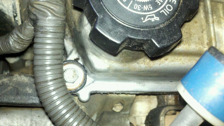

I recently did an oil change and found that there wasn't much oil on the dipstick but plenty on the skid plates...so I began a search for the source of the oil leak. At first I thought it might be just a worn out plug washer, so I did another oil change to replace that. It still seems to be leaking though so I continued my search. Today I noticed oil on the exhaust manifold so I put my hand under the valve cover and it was pretty oily. I took a pic of the spot that caught my attention....so opinions? I didn't think valve covers were a problem with this motor...and since I'm due for a timing belt anywayis it much more work to replace the valve cover gaskets?

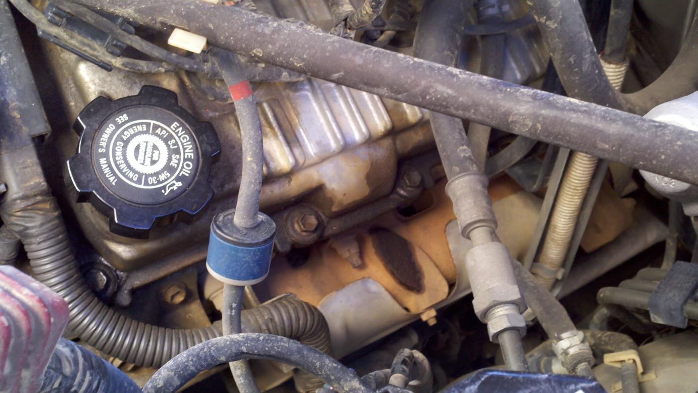

Today I tightened the bolts on the valve cover. They seemed very loose to me, in fact a couple I was able to turn by hand. So I took the trusty old 10mm socket to them. I let the engine warm up to operating temp and watched as oil dripped from the cover onto the exhaust manifold. Thats when I grabbed my little 10mm wrench and tightened them more! As I was tightening the one on the drivers side closest to the bumper, I heard a pop...and sure enough its cracked now! Moral of this story is, if you don't know you're not supposed to really crank them down, then leave them alone.

They are only supposed to go to 10-15 ft.lbs. I cant remember. Unfortunately the drivers side requires the intake manifold to be removed.
I was having the same issue. I keep finding that i'm low on the dipstick and couldn't figure out why. I then found oil on the manifold too and pulled a wrench out to tighten them. I just snugged them up because i was afraid of them cracking too. Every bolt needed tightening. Are the heat cycles that intense that it's backing these bolts out? I guess i'll just keep checking up on them every oil change.
More like the vibration from the motor.
