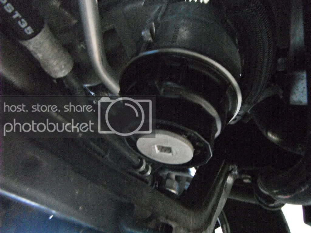

It looks like they forgot to put the plug in. Wow
Yep bottom plug is not there, that's what I'd call an Express oil change special there. Man I'm so glad I changed my own oil yesterday, have been for years and these type situations validate that decision over and over again. Hopefully this all works out for you in the end

I'm not sure if you're familiar with what the assembly looks like normally, but I've scavenged a pic from Antman's excellent oil change writeup.
Oil Change 5th Gen: How To- LOTS of PICS!
That plug is missing, and there's actually a check valve on the other side of that, or all the oil would be gone.
Good luck-- keep us posted
