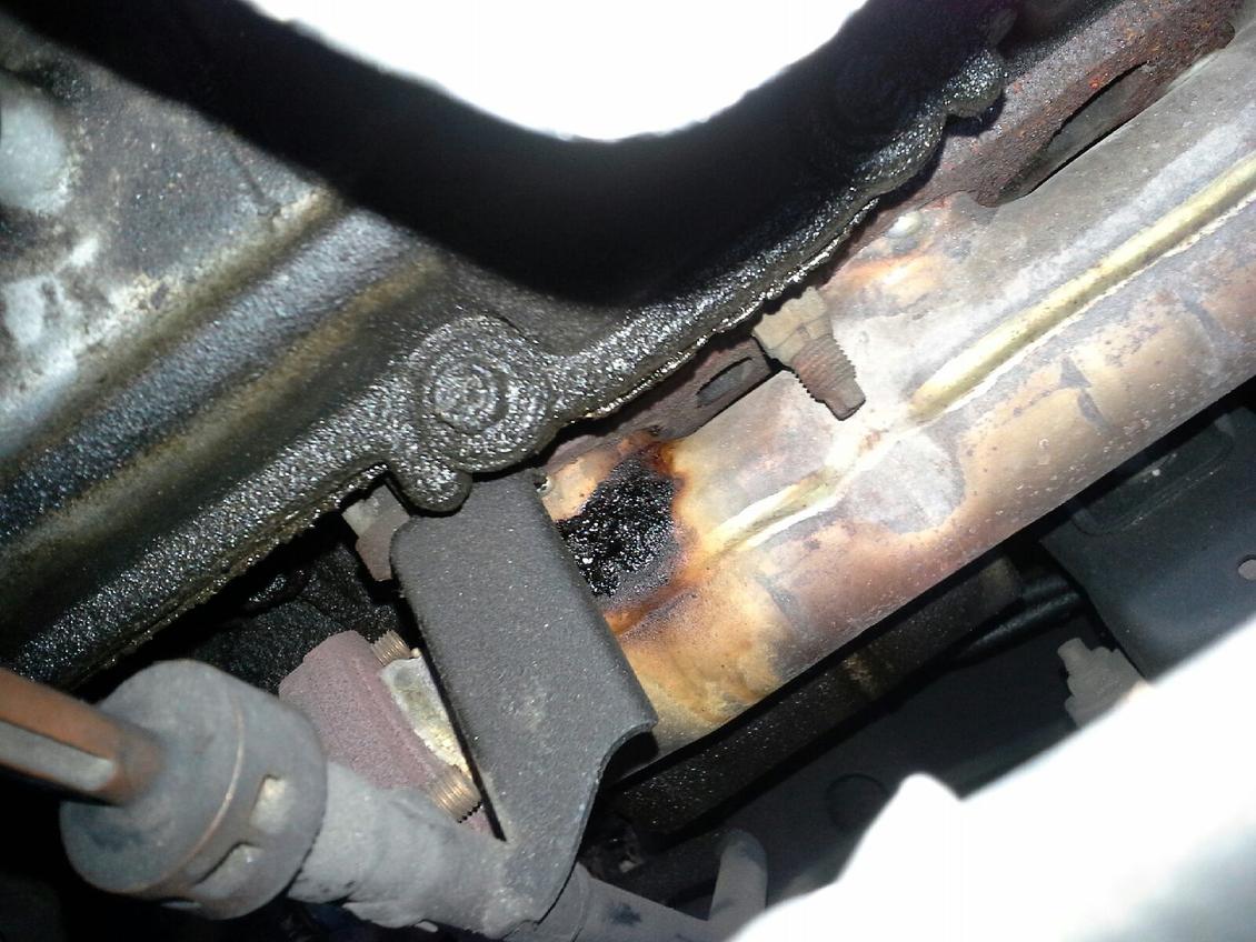

2001 2WD 312k miles, valve cover leaking on exhaust manifold. How much of a fire hazard could this possibly be. I don't want to have a car fire. I'm gonna have my mechanic repair the leak. I don't have the facility or time to do it myself. Also, could the oil leaking cause corrosion on the manifold? Thanks.

The oil is leaking from your valve cover gaskets (common issue on our rigs) onto the manifold and the gaskets need to be replaced. If nothing else, take a 10mm socket and tighten your valve cover bolts until you can get the gaskets replaced. It is not a difficult job. Depending on the mileage, you might also consider sealing the half moons and the cam covers when you are in there.

Be very careful doing this. The torque spec is 52 IN LBS. The valve covers have been known to crack if over torqued
This engine was bone dry until around 200k and the leak has gotten worse over time, very common. I checked the tightness a few years ago and the bolts I could get to moved 1/8 to 1/4 turn. I know how easily the vlv cover can crack and also, overtightening can make the leak worse. My main concern is a fire hazard from the heat but I agree, that's unlikely. I don't need my truck burning up on the Lake Pontchartrain Causeway! (I drive it twice a day, 80 mile commute round trip) I'm also concerned if the chemicals in the oil could corrode the exhaust manifold. It looks like it's either SS or possibly titanium. Any thoughts on this. (I know "Just fix the leaks!")

Valve cover gaskets most likely. While your in there, be sure to replace the cam caps and reseal the half moon plugs.

Oil helps stop stuff from corroding. Burnt on oil can be nasty to clean off porous manifolds, though.
It would be very strange if you actually had a titanium exhaust manifold on a 4Runner :)

The manifold itself is cast iron, the heat shields might be stainless steel or a coated steel of some sort. The oil may cause discoloration, but there won't be any structural damage.
