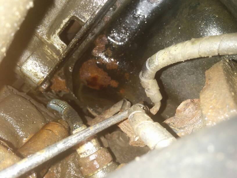

It's right at the back of the pan on the bottom. In front of the transmission. You could get at it pretty well by loosening the steering rack. The trouble is, the pinhole is from rust. Rust and engines don't mix well so I think I definitely have to fix it permanently with a new one
