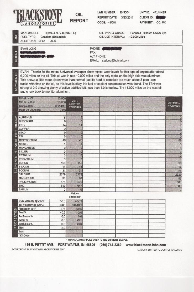

I got my results back today from Blackstone Labs.
I ran Pennzoil Platinum Ultra Synthetic for 10k miles with a Mobile One high-capacity filter. Bottom line the results were good as expected. They suggest going 11k next time to see how the oil holds up. My 4runner is V8 with 132k miles. Their report is very detailed, service was fast. They ran the sample and sent the results the same day it was received! I'll attach the report for anyone who cares to read over it. Looks like there was a touch more aluminum than is "average" but not much of a concern according to the report. Maybe due to a higher mileage vehicle? Maybe from taking the sample from the first of the drained fluid rather than from the "middle" of the flow?
At any rate, I'm very pleased that I can go 10k + miles with out an oil or filter change. I'll run another sample at 10 or 12k and see how that turns out. Oh, and I'll pull the sample from the middle of the drain flow, not sure if that matters on a warm engine, but we'll see.
Sorry but I had trouble blacking out my address and being able to attach the pic/pdf...I'll check back if it didn't work or is not legible.

Anyone have any thoughts on the slightly higher AL? I know it's not really a concern, but I'm curious where it comes from.

Excessive AL? The block/head are made of AL. BUT, the cylinder walls are lined with Fe.
"This engine has special cast-iron cylinder liners cast into the block, which are a spiny type to improve adhesion between the liner and cylinder block. With these special thin liners it is impossible to bore the block. In the event of cylinder wall damage (scoring, deep protrusions, etc), the entire cylinder block must be replaced. "
Source: 1GR-FE wiki :hatsoff:

As far as the aluminum, I wouldn't sweat it since the Toyota engines may very well employ a tad more aluminum than other engines. Look at it like having bloodwork done; there's almost always a parameter or 2 that are just outside the "norm". I believe you're good to go.

Nothing guarantees the oil filter will last to 10k. Depending on operating conditions. It will by-pass when dirty. Say, in my case, you picked up a used 4r with 50k and the previous owner used conventional oil and changed it 7-10k. Resulting in light sludge. This is an unknown, I do not know how what and when the previous owner changed the oil.
The high detergent nature of synthetic oil. Will wash the sludge and contaminants out of the engine, and onto the oil filter. Resulting in clogging and bypassing of the filter. Followed by the oil progressively getting dirtier.
For me its cheap insurance that the filter and engine stay happy. I don't mind paying more for the synthetic. Ultimately i am trying to clean the engine to eliminate the unknown.
Judging from the results of your oil. You should stay the coarse. On your interval. Me personally, im not going to push an oil filter past 5k.
I agree 100% that one never knows when their filter life is up. I would guess the "high capacity" filters will do fine for my vehicle running 10k miles, but I guess I'll never really know. To be on the safe side, I'm thinking about doing a filter change at 6k and sending my next sample off at 12k. Haven't really decided. I'm confident I'm ok w/ 10k on the Mobile One filter. Wouldn't there have been more "dirt" or minerals show up on the sample if my filter had been full and bypassed?

I got a reply from Blackstone labs. He said "the filteration looks great" he went on to say he would stick with the filter I used.
I'll read over that link today, just wanted to pass along what blackstone said.

Thanks for the info. Is there a reason you are using 5W20 instead of 5W30? Colder season, improved MPG, etc? I thought about using 5W20, but I wasn't sure of the benefits over the 5W30 recommended viscosity. I just got my '07 T4R V8 about 5000miles ago - now with 84000 miles. I changed the oil to the Penz Ultra right when I got it, i'll be changing it early and soon to hopefully remove any deposits the syn oil loosened up before I go to 10K-15K service intervals. I do have an '01 Corolla that has 235K, over 150K on syn oil. I did go to 15K a few times and had the oil tested from TitanLab, on one of those 15K runs. I do change the oil filter at 8-10K when going to 15K. The test came back just fine - I did use M1 5W30 Extended Performance in the past. Now I need to test out the Penz Ultra to 15K.

No reason I went w/ 5w20, just what Toyota calls for? I think?? I'm always open to suggestions, I've already changed it to the same 5W20, but maybe next time I'll do some more reading.
