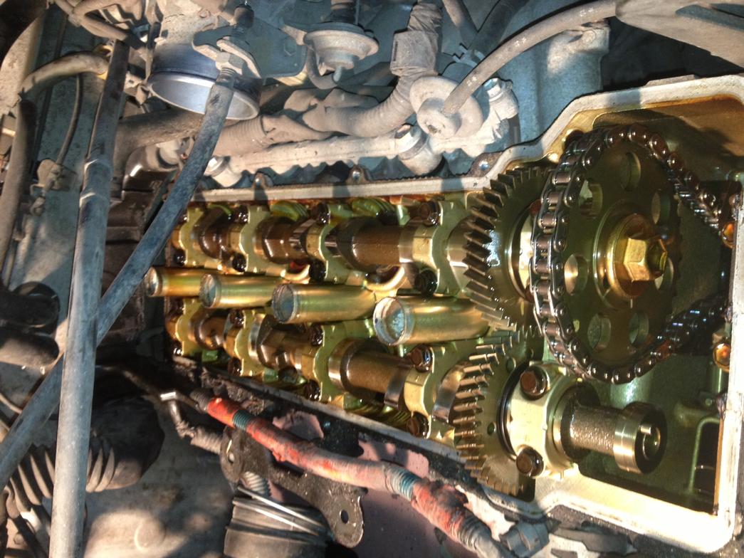

No biggie. Just replaced my valve cover gasket and it too was leaking onto exhaust manifold. Have the seller pull valve cover and inspect for sludge buildup. Hopefully it looks like this.

they might but its not just a 5 minute pull.
if anything passenger will require the least amount of effort but even at that, if they are going to take it off anyway whether you buy it or not they mind as well do the valve cover gaskets since its off.
depending on the person's mechanic skill level it can take anywhere from 20 minutes to an hour to get just the passenger off with the right tools.. possibly.. im just guessing since i did mines the other month and took around 2 hours to do both sides start to finish.
but yes not much to worry about, valve covers are regular maintenance
